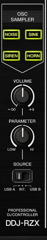

Hi everyone,
From reading the DDJ-RZX Hardware Manual it seems that the midi signals of the 4 oscillator buttons are sent to Virtual DJ only if the switch is positioned on USB A or B. I have instead noticed that the midi messages buttons are sent even if the switch is set to Internal so having assigned 4 samples to the oscillator buttons, the samples will play themselves correctly if the switch is set to USB A or B but, if I set the switch to Internal to use the oscillator, when I press the buttons the samples will still play along with the oscillator sound. This is very annoying, is there a modification to prevent this from happening?

I solved it using variables!

You set the "SOURCE" switch to set a variable depending it's position.
Then when you receive MIDI from the buttons you check the variable value before deciding what the button should do.
