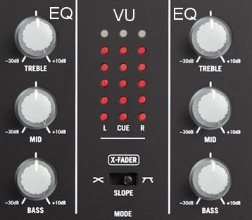

Thank you so much for support so far.
Would you say that the issue is caused by the fact that I do not have licence so VDJ acts weird by sending sounds to both channels?
Also I would like to add that I did another test which is to add a track on the vdj deck 2 only instead and still my mixer EQ shows sound on both channels

Hi
I tried all possible scenarios and I got the same issue. I decided to call Numark to get an advice about it and they said that the mixer EQ is related to the stereo left and right channel and not the channels of the mixer itself which is a little bit misleading by reading the specs of the device. I am very disappointed about it. Therefore everything is normal and Numark also assured me that there is no sound on the other quite channel.

Oh. A bit odd design choice for the LEDs ...
At least you figured it out, i would never have guessed ;-)

@scuolacalciorecoba you keep mentioning EQ in this thread, but I believe you're referring to the VU meters (the LEDs that light up).
The EQ controls are the low, mid and high knobs for adjusting the bass, midrange and treble.
That's normal. The VU meters show the master output, not the levels of each mixer channel.
Quote :
the mixer VU is related to the stereo left and right channel and not the channels of the mixer itself
Posted Sat 12 Mar 22 @ 5:02 pm
@grovindj - I kept mentioning it until I found out that it was VU. I thought it was an EQ in the first place as I could not think of any reason why you would put a VU thlere. Is there any DJ or music player that would enter a mono input or need a VU?
