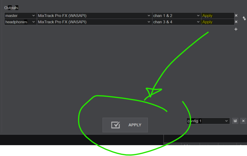

Hmm strange. If you have audio AND you see volume fader and crossfader move in the software.
Can you paste and upload image of your sound settings here:

But maybe you inverted headphones and master. If so you could always try the headphone volume knob on the controller, and see if that lowers the speaker volume. But maybe not likely, worth a check ..

Posted Thu 10 Mar 22 @ 10:19 am
your audio config is not applied
Posted Thu 10 Mar 22 @ 10:41 am
Did you just change for the screenshot? Those sound settings are not really in use (yet)
Posted Thu 10 Mar 22 @ 11:18 am
And if you get an error after you press "Apply",. it might be because the sound card on the controller is already in use (elsewhere), most likely as Windows default sound card if so.
Set it so that Windows does not use the controller as playback nor recording device
