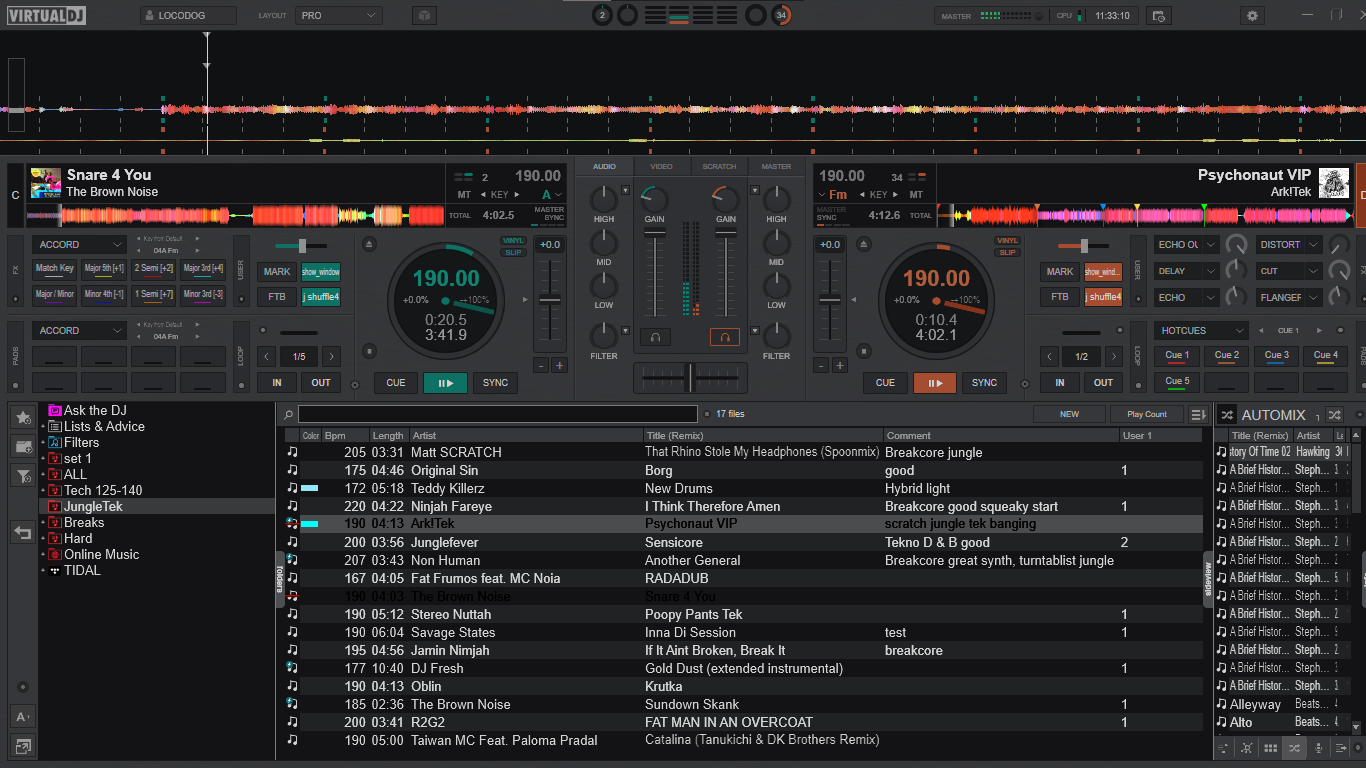

I started picking at it, what you're looking at is a external window with decks 3&4 as a 2 deck skin, still some things to iron out
not sure why it appears a few pixels wider [@devs any hints? window is 1920*1080, will resize correct but a skin reload and it gets a bit bigger]
bits needed to idiot proof, and only the basics of skin layout options tested so far [scratch panel works though]

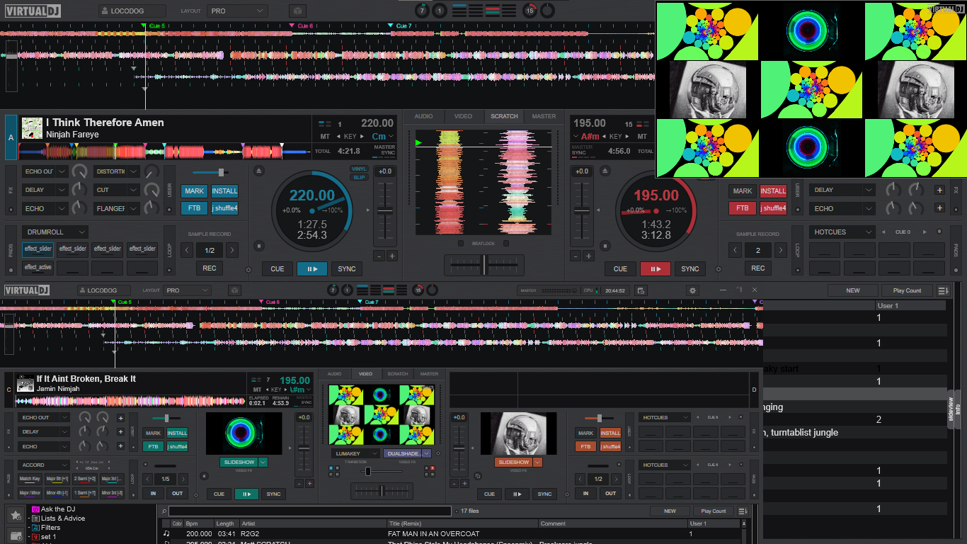

locoDogPRO InfinityModeratorMember since 2013
further picking
A bit to take in, [this is a single whole screenshot]
mixer tabs are independent between the 2 windows [main on scratch, secondary on video]
video preview are sourced from deck [not left/right video]
a few little changes to specified deck [not deckleft/right] mainly vu's
I learnt a thing or two along the way. Probably bits still to fix.

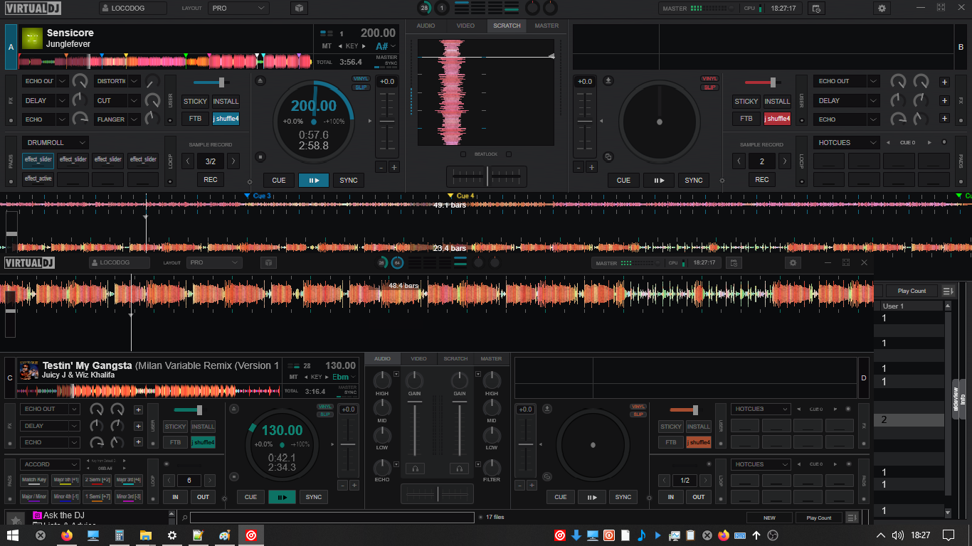

now the following are independent to the each screen.
jog type
colour scheme
wave position
waves shown, local decks or all 4
I've not thought about 4 deck mixer, or showing mini decks for the opposite screen's decks. yet to look at wave colour scheme.

I've got the mini decks sorted and a choice to not show them if you wish.
link in pm.
