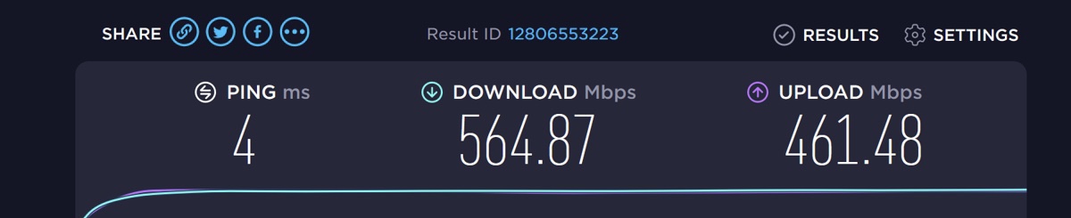

Yeah I have been working on my upload speed and this is the best I can get it
Posted Fri 25 Feb 22 @ 6:54 pm
oh wow.. thats more than plenty ;-) so thats not it
