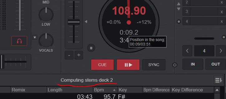

If you have an old laptop you need to make sure that the stems separation is finished before you use them
Could that be the reason?
You can see if the separations is done right above the browser (the text will disappear where it's done):
The songs will play fine before the stems calculation is done - so it can be a bit confusing
