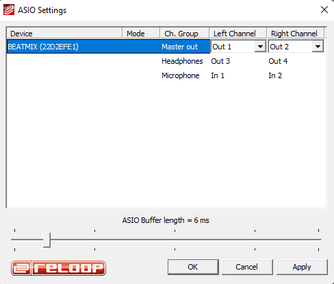

When you click on the ASIO button you see in VirtualDJ Audio Setup, and get the Reloop ASIO Settings panel, are the Channels set as the pic below (Master Out 1,2 and Headphones Out 3,4 )?
Posted Tue 22 Feb 22 @ 5:13 am
Ok, we plugged our Beatmix here and everything works as expected.
Reloop ASIO ver 1.23, default Audio setup as shown in your pic, Reloop ASIO Channels as shown in my pic above, CUE/MIX knob at far left (minimum) and SplitHeadphones setting to No
