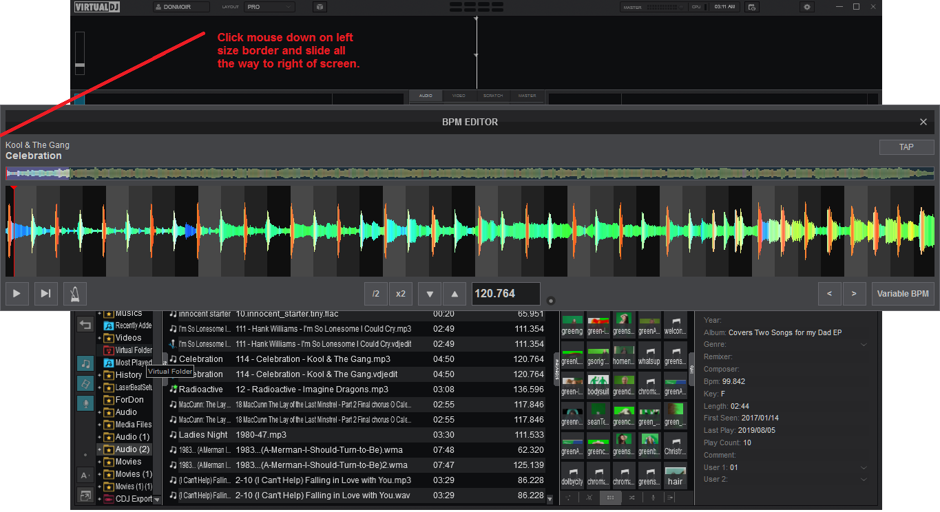

Open BPM editor. Size it across the screen as in the following image. Must be at least some certain size. Grab the left size border and drag it all the way to the right like your dragging it off screen. Release mouse and should be hung up now. Crashes every time here.
Posted Thu 17 Feb 22 @ 8:26 am
I can reproduce your hang also, without controller attached (but with modified Pro skin)
UPDATE: Same hang when testing with default Pro skin. VDJ 6839
No need to first, stretch the BPM editor across the entire screen, just resize the BPM editor to zero width, as shown in screenshot video.
https://gyazo.com/4a94a5c848c95e9bb15a7d0cbcdcb614
Hope this helps.

It happened accidentally the first time. I went to move the editor and grabbed the size border by mistake and ended up moving the whole thing. I don't bother actually trying to test VDJ too much anymore because it became a waste of time. But it doesn't matter if you would never do that or it happened by accident. Bugs frequently lead to other bugs and sometimes worse then the thing that triggered the bug. So it's not your job to decide on the severity of an error etc. and it's an important thing to know that. No one really knows until it gets investigated.
By the way I had changed the skin prior to the crash and not sure how long it was till crash happened but the skin change was not saved. Repeated the test about 4 more times and also changed skin each time. On the latter test the time between skin change and crash was about 15 to 20 seconds. Skin change not saved.

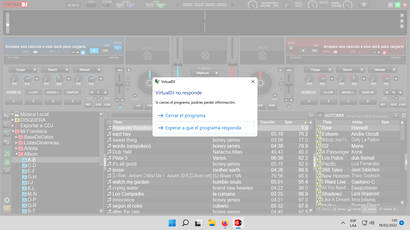

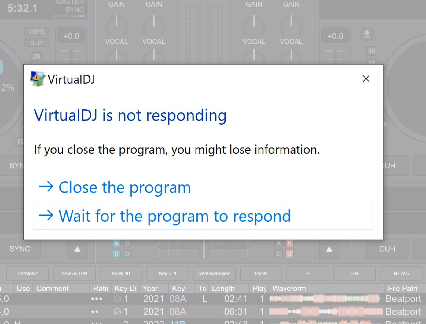

here totally frozen.
I did a manual reset.
there was no automatic restart
Best regards
