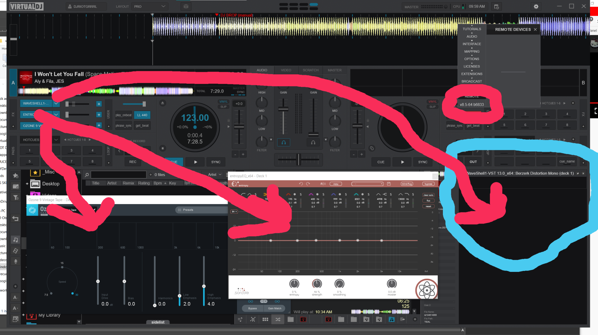

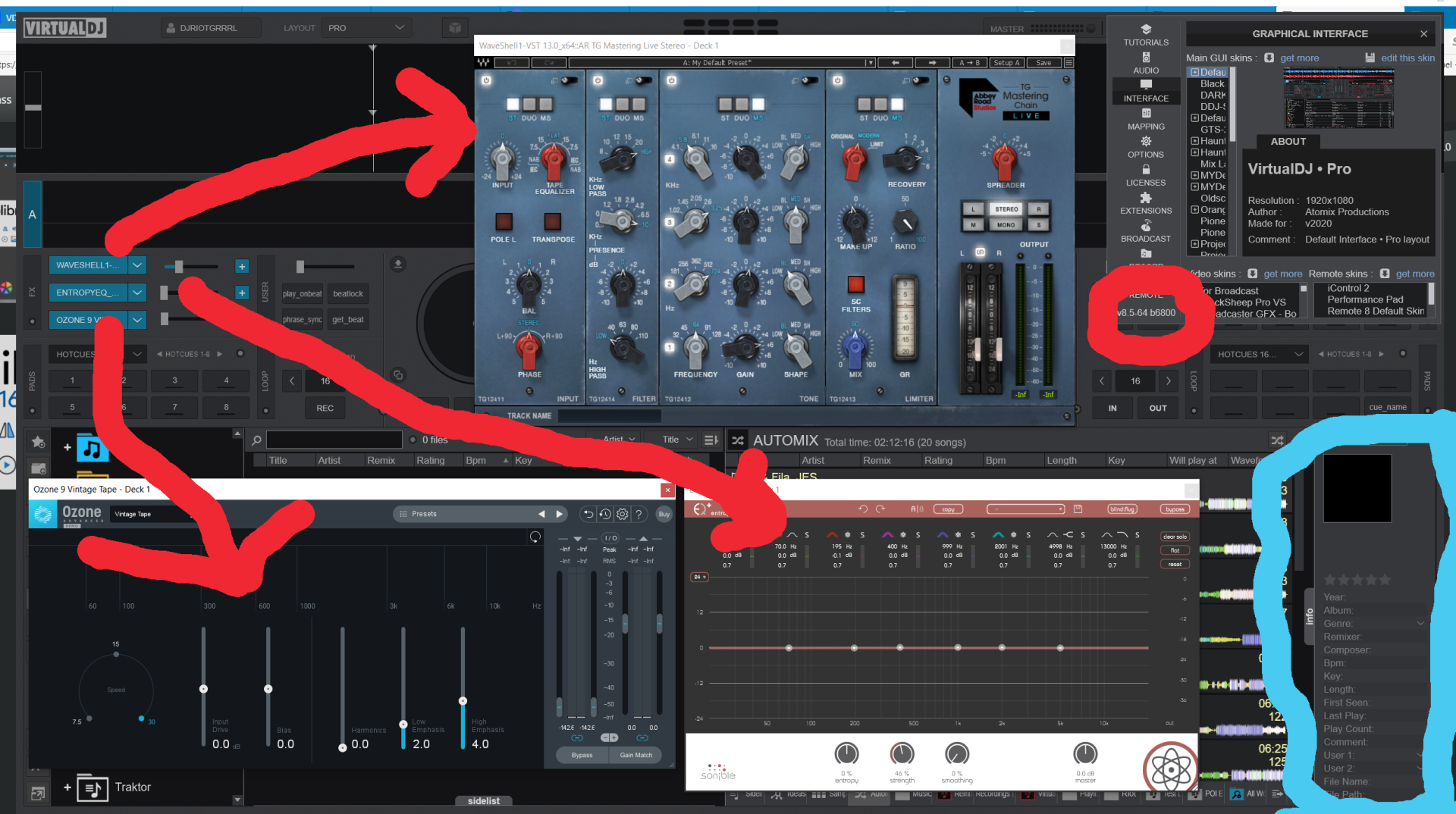

The issue in b6833 is that the Waves plugins are not opening in their native windows and instead are trying (I guess) to open in the VDJ plugin window. In b6800 and all previous that I have used the Waves plugins open in their native plugin windows. Plugins from Izotope and others DO open in their native plugin windows in b6833 and before.
Switching skin engines has not effect on the issue.
Attached are two pictures. One is off b6800, which works properly with Waves plugins, and the other is of b6833 which does not work with Waves Plugins.
Explanation of pictures:
b6800 Waves.png shows three plugins and there native plugin windows. The plugins are from Waves, Sonible, and Izotope. The red circle indicates VDJ version. Blue circle indicates that no VDJ plugin window is open.
b6833 Waves.png also shows three plugins but only the ones from Sonible and Izotope have open navtive plugin windows. The Waves plugin in this version tries to open in the VDJ plugin window as indicated by the blue circle. The red circle indicates the VDJ version. (NOTE: The fact that this picture shows an open song should be ignored as whether a song IS or IS NOT open has no bearing on the problem.)
Let me know if you need more info.
Thanks
RiotGrrrl
Thanks
RiotGrrrl

Thanks, problem found, a fix will be available shortly
Posted Wed 09 Feb 22 @ 4:32 pm
Should be fixed in 6839

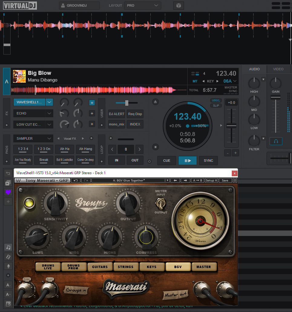

I'm not a Mac user, but I can tell you from the PC side of things, that VST3 plugins live in their own specific system folder, and it's not required (as it it once was) to copy them into the VDJ folder.
Also, Waves plugins run through a wrapper (WaveShell) rather than directly, so you have to load/run the wrapper to use the plugin. At least that's the way it works on PC.

Keep in mind then that VirtualDJ itself runs as a native ARM application and it cannot access plugins that require rosetta.
In this case it IS possible to switch VirtualDJ to use rosetta instead in order to access the plugins, but I think this comes with a performance penalty..
