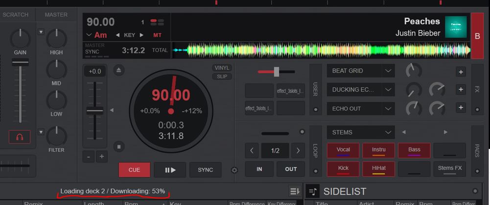

A relatively new thing to remember here is that your waveform is potentially cached (the cache was added in a recent version), so you can't trust that the track has been fully downloaded even though you can see the entire waveform - like in my example below (from Tidal):
Here yo can see the full waveform on deck 2, but the track is actually only 53%downloaded
That's because the waveform was cached from a previous download
Could that be what you were experiencing?
