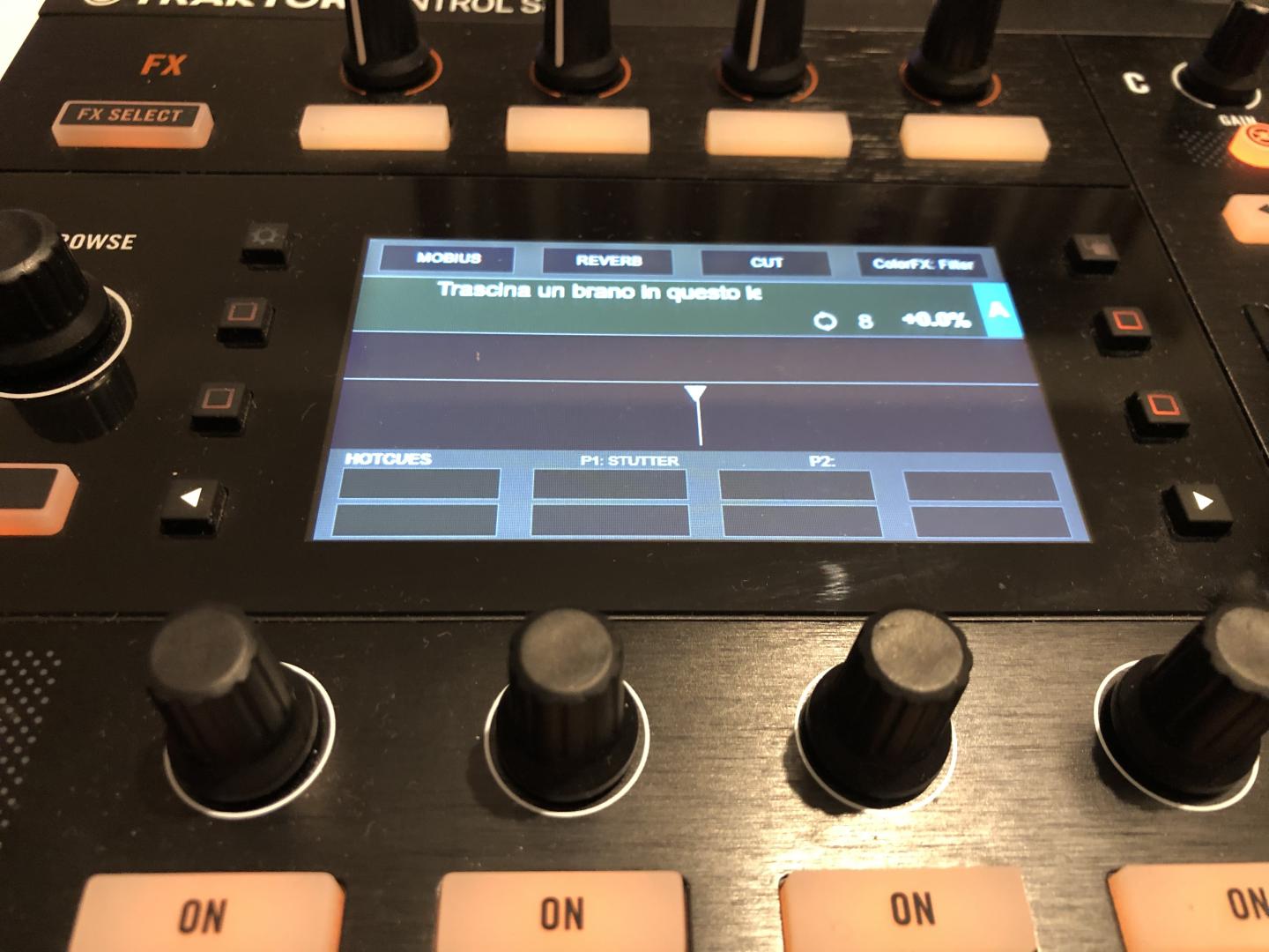

..any update with pad mode?? the waveform restricted and under waveform make 8 pad like Denon Prime Go…
Posted Mon 04 Mar 24 @ 10:55 am
..and now S8 screens have pad 😊
