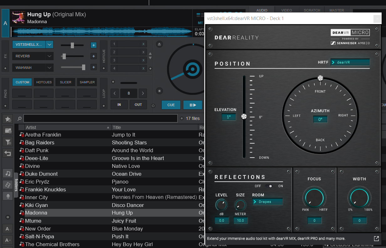

Adion wrote :
Which plugins are you all using that are not available as vst2?
The one in the screenshot above is the first one I've encountered so far but there will be more as I've been uninstalling ones that didn't work
Posted Fri 04 Mar 22 @ 10:00 am

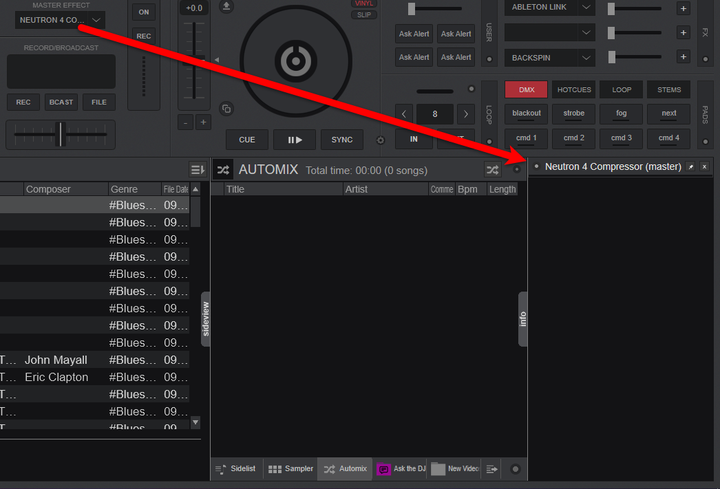

Running VDJ 7131 already, and I did test this ahead of time. However, it looks like I was moving the DLL from the VST3 folder and not the VST3 file itself. My fault there.
The next issue, though, is that when I click the VST settings (gear icon next to the effect), do I just get a VDJ pop-out next to Auto mix and not the VST effect window that allows me to configure the plugin?
