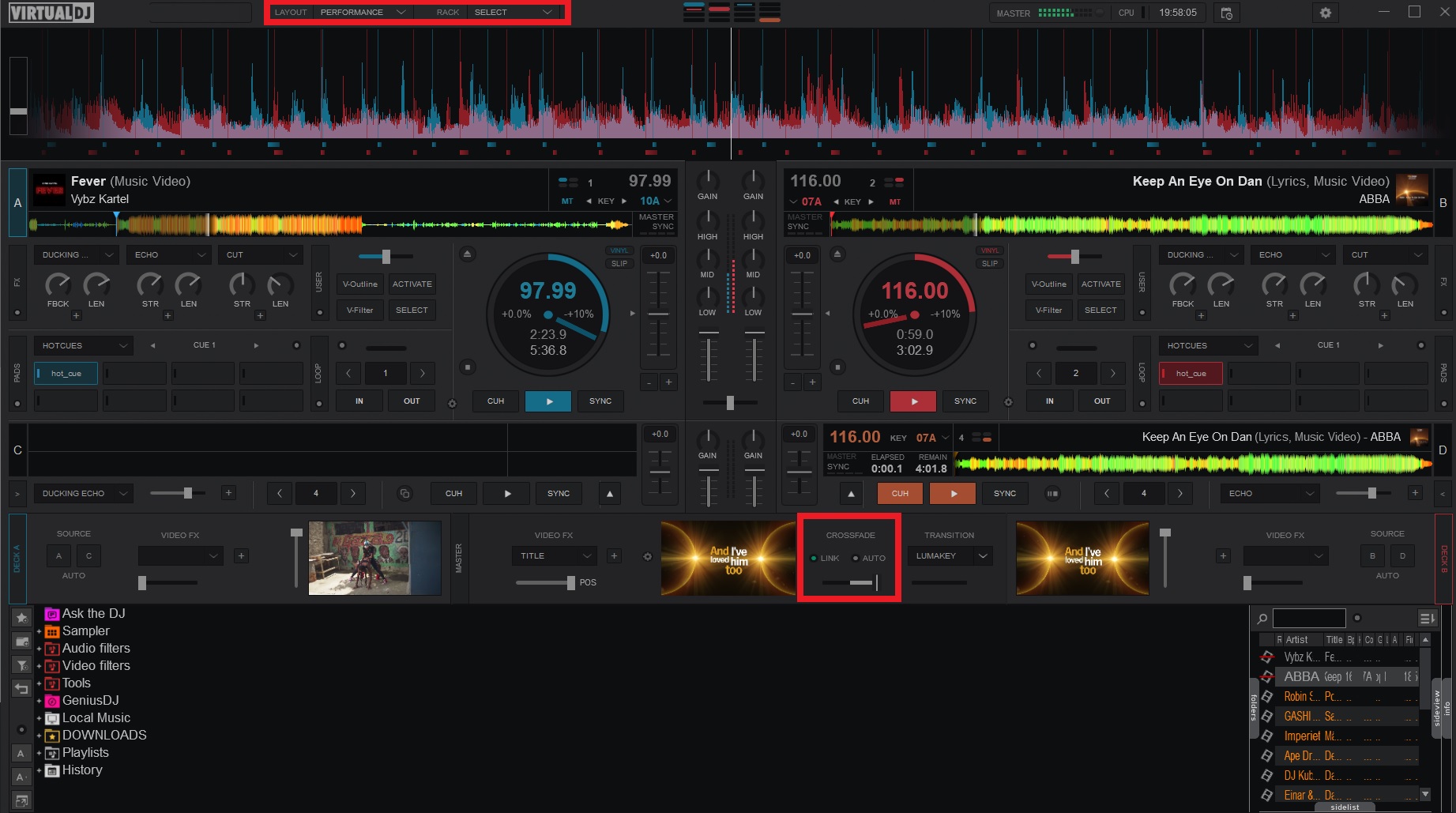

This is Vdj Original skin.
Use layout Performance & Rack Select Video.
Now use the Video Crossfade in the video section, and click on Link instead of Auto below to use it :)
