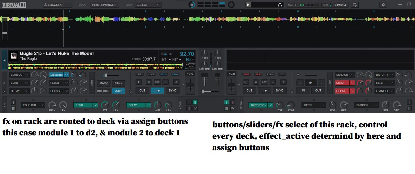

thanks, but a question remains, picture case; rack is only deck 5 [not intended to ever load to deck 5] all other decks fx follow, decks effect on/off determined by both state of deck 5 fx && if "send" buttons in centre of rack are on/off
where would the pop up appear after your tweaks?
over called slot on the rack would be ok, ideally it would be the centre section of the rack if I could specify.
ultimately decks 1 & 2 wouldn't have a visible fx panel [as the info is on the rack] and popup over rack slot 1 could cover what's going on on slot 2
