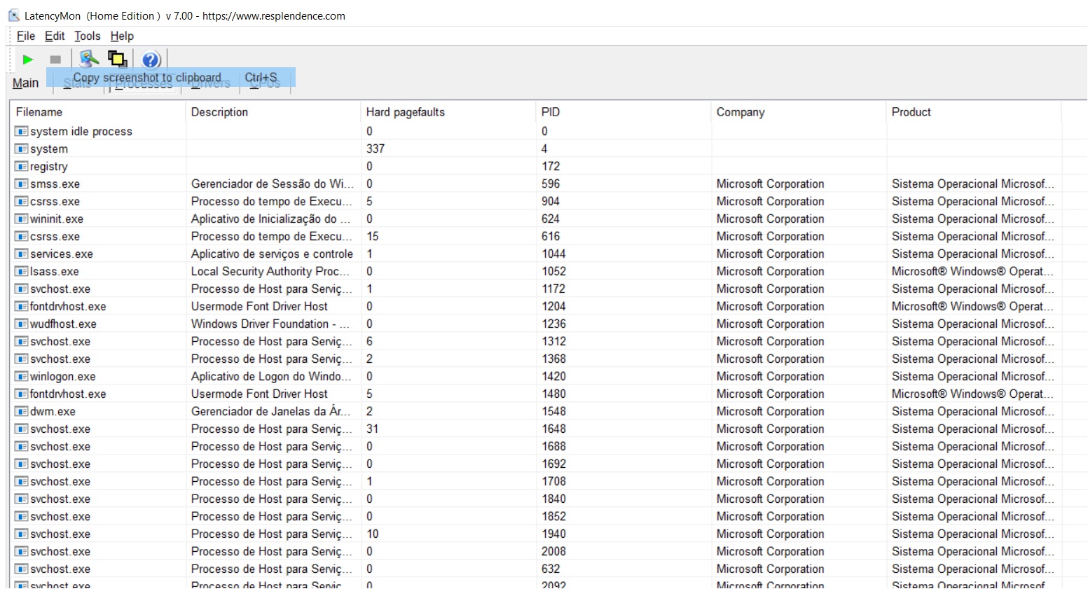

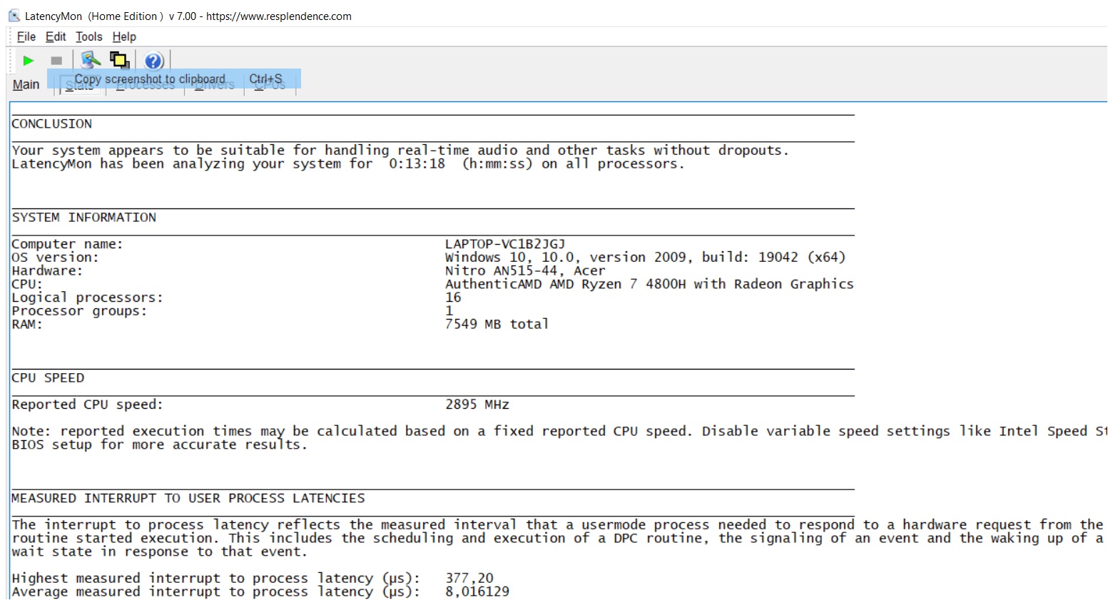

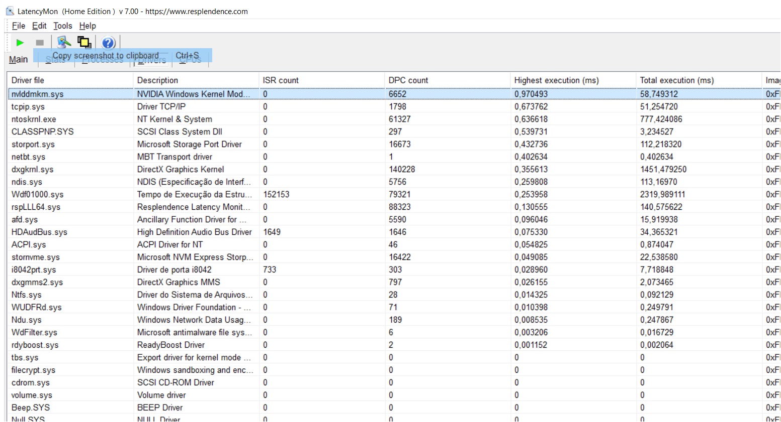

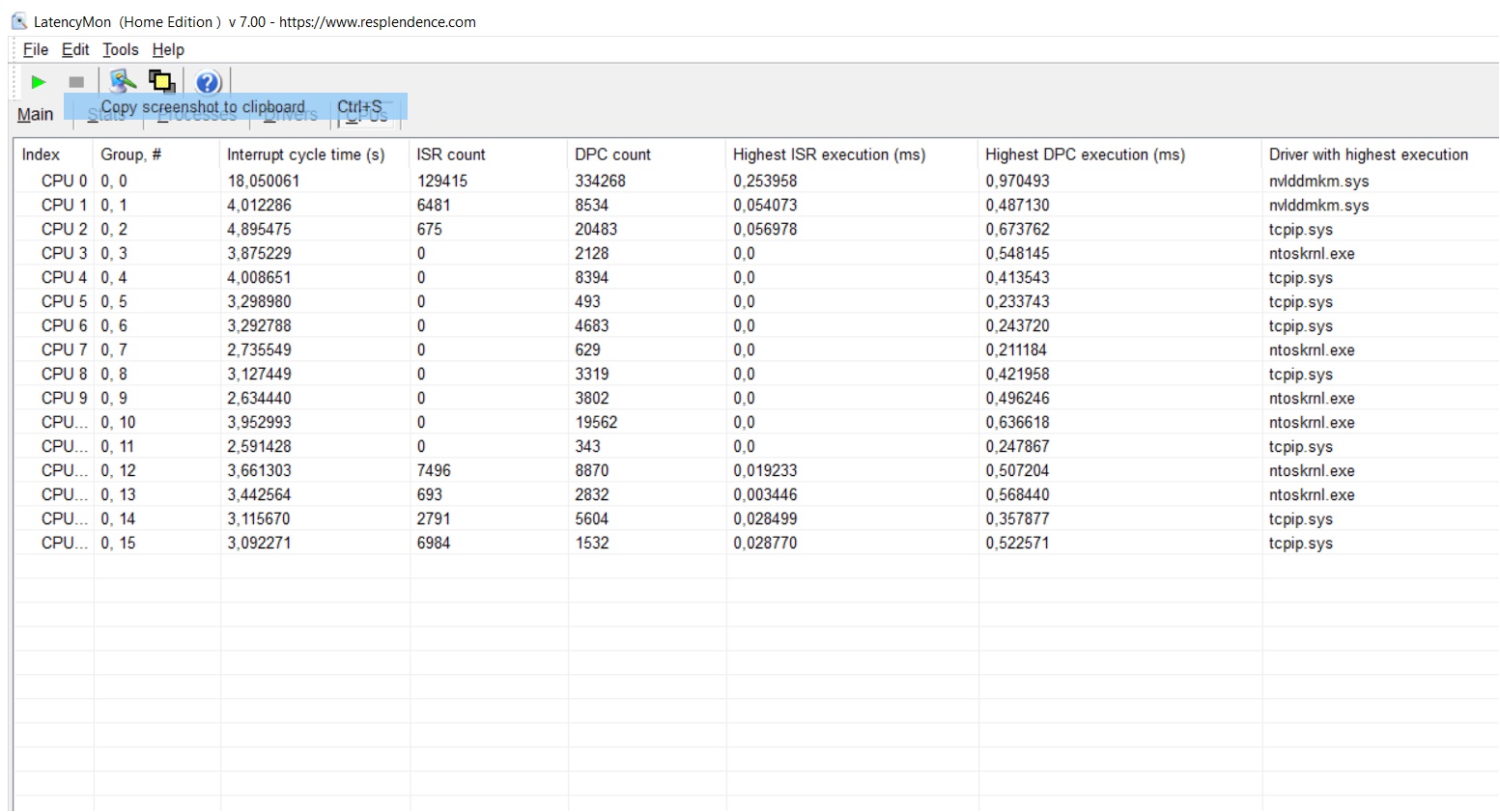

Hello, just ran bloatware removal tool and ran the latency test. Any suggestions of necessary actions regarding the test results below? I don't understand everything pretty well... Results below:

those results look good,
run vdj with latencymon in the background, see what it pulls.

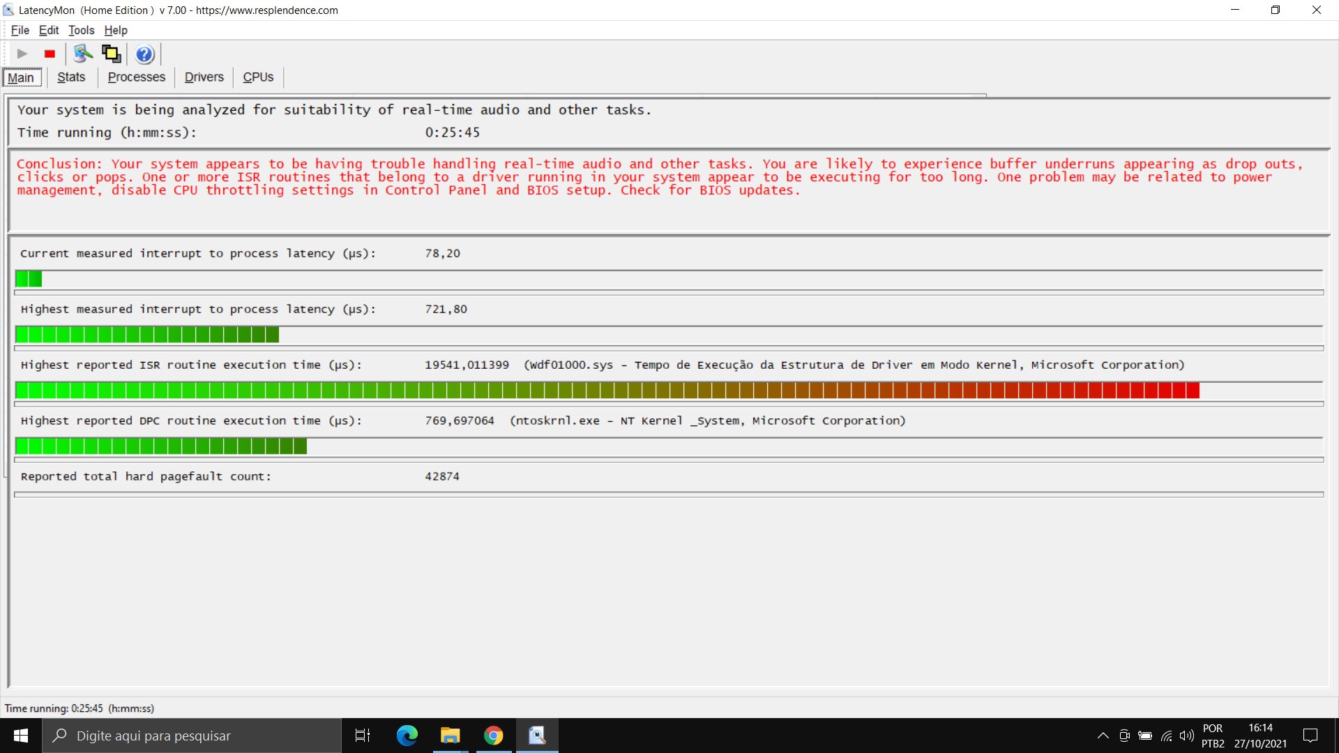

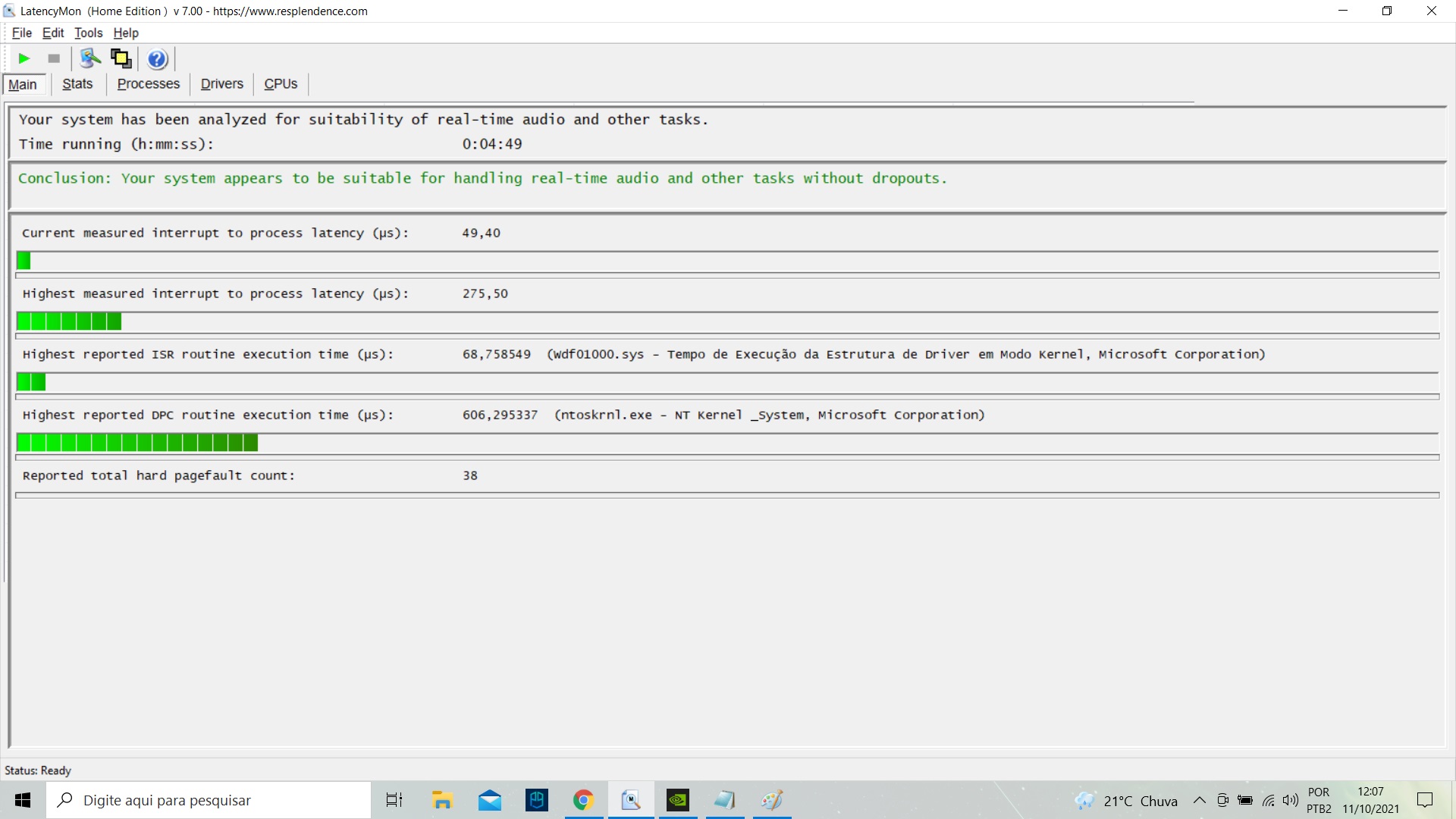

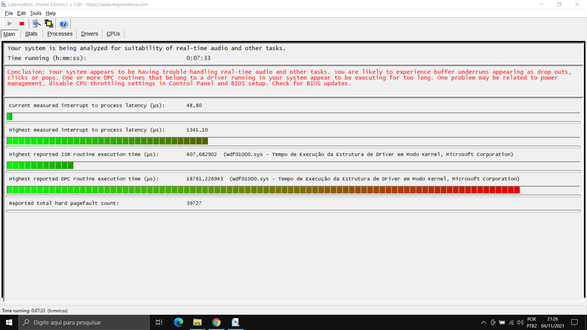

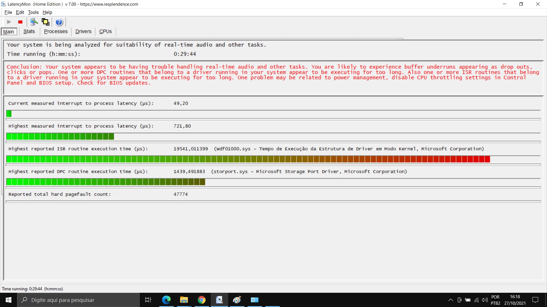

After days of exhaustive testing I managed to find small hints to what might be causing the stutters. It seems to be related to something called wdf01000.sys. By the love of God, i beg for you guys' help. I'm getting depressed over this issue already and it would REALLY mean a lot to being able to fix it. Please find the screenshots below and suggest me what the hell can I do to get better rid of this plague in my life:
Side note: I have already done the following procedures and none worked so far: fully reinstalled windows from scratch (clean install); fully updated all drivers (yeah, ALL of them); checked if bios is updated (it is the most updated version), increased latencies both in VDJ and on my controller ASIO driver; removed all bloatware; uninstalled all acer related programs; set GPU usage to high power in VDJ settings, changed pc battery plan to high performance.
Please, kindly help me!

wfd01000.sys is a driver interface from Microsoft, it is not part of a specific driver, so it does not directly point to the actual driver or program that caused the latency spikes.
For Dell that seems mostly related to the Dell Support Assistent program, but for other brands it might be something different.
Network drivers have been known in the past to cause this too (although usually doesn't seem to be an issue anymore), which is why the suggestion was made to try with wifi disabled.
You could try google with wfd01000.sys along with your computer's brand/type and 'latency' to see if other people might have identified the specific cause.
