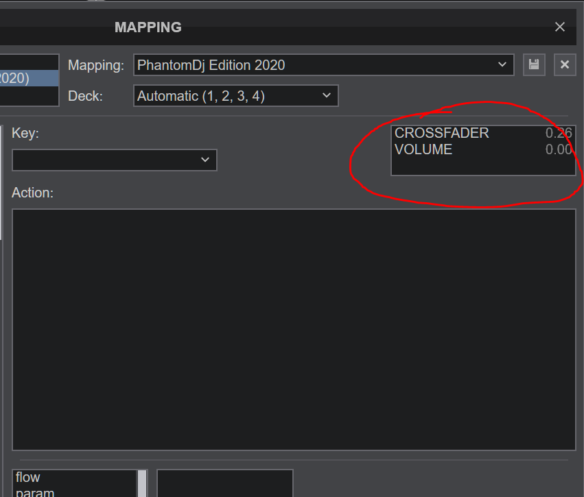

          When the track starts skipping please open VirtualDJ config, click on MAPPING icon on the left and then select Pioneer DDJ-SZ on the top left side of the window.
Then take a look on the right side of the window where all recent keys get displayed.
Check that this portion of the window does not display any keys that you don't actually use / touch at the moment.
If after you open this window you don't physically touch your controller at all, the window should stay empty.
If it doesn't then the controller is sending unwanted MIDI messages. Depending on the keys you see there, we can make some assumptions as to what's going wrong and if your controller may need to be serviced or not.
I'm talking about this section of the window:
