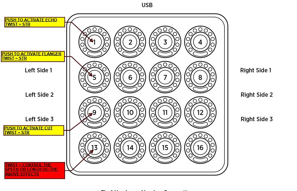

Hi all,
I'm not sure if what I'm asking can be done, so far I have;
Echo on 1 (Push to activate)(Twist for the strength)
Flanger on 5 (Push to activate)(Twist for the strength)
Cut on 9 (Push to activate)(Twist for the strength)
I'd like to utilize 13 for all of these effects with a 2nd parameter either Speed or Length. All effects are 'deck _active' & are working but without the 2nd parameter.
As I've said before i only have a really basic knowledge so any help is greatly appreciated
Thanks

effect_slider 'echo' 2 & effect_slider 'flanger' 2 & ...

An alternate method of configuration for an FX setup, that may be of interest:
Set the MFT Switch Action Type: Shift Encoder Hold
(so one can have a second encoder function when each encoder is depressed and turned, for the secondary FX parameter)
The FX can be activated with momentary depress of the button action, with the button mapping structure of:
holding 200ms ? nothing : toggle FX on/off
Each Encoder knob can control strength (and length when depressed) for each mapped FX
and effect, toggled on/off with the momentary depress
