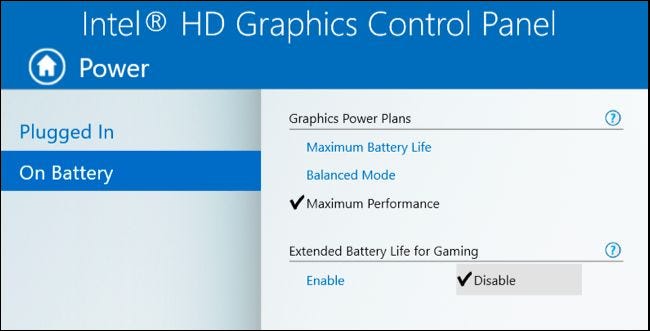

Just to rule out stems engine is too heavy for your computer specs, you can try set precomputeStems in settings to "Only use precomputed"
Additionally if its a low end graphic card, make sure the Intel onboard graphics are set to max power, as well as laptop. Both for battery and plugged in if using both
Posted Wed 19 May 21 @ 11:11 am
Thank you very much Rune. Its now working.
Posted Wed 19 May 21 @ 6:11 pm
