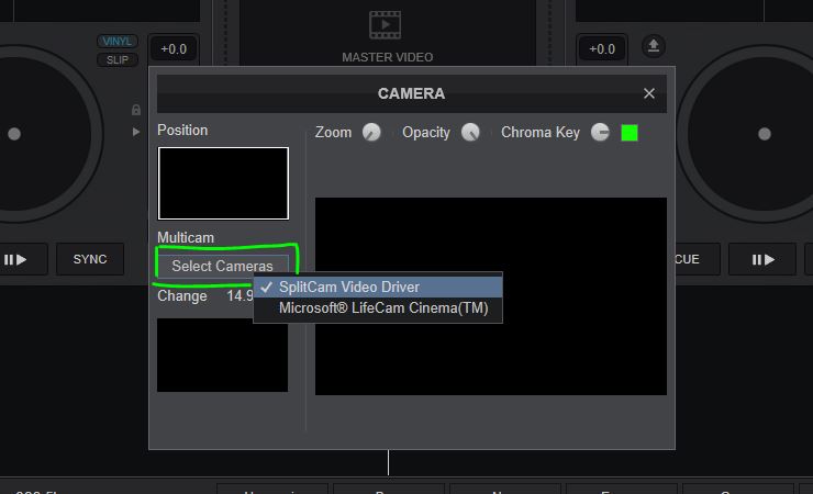

Camera is probably the selected effect when you start up VirtualDJ then..
If its in the selected slot, its in use.
In the camera effect settings at the "MORE" button you can also select what cameras VDJ should take.
If its a camera you want to "exclude" deselect it from the "Select Camera" options
Works fine my end at least.. can start VDJ with camera effect selected, enable camera fx etc.
And the unselected camera works fine in other apps all the time

yes I can select, activate, deactivate etc. my first and/or second camera here,
and I can deactivate my third and fourth camera here, this is not a problem!
But even if I deactivate the third and fourth cameras here, VirtualDJ will not enable them,
so that I cannot use the third and fourth in my other program.
You have already tested it with four cameras?
It doesn't work devinitive!
