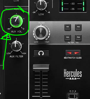

Bottom line, all will work great ;-)
Dont worry. . its only the line-input that you might not be clear on.
But its easier than you might think. Just connect to aux at the back, and use aux volume knob at the mixer (and dont think about it inside VirtualDJ, rather think of it directly the mixer only)
Just as you use the channel volume knobs (or crossfader) to adjust volume from music of VirtualDJ

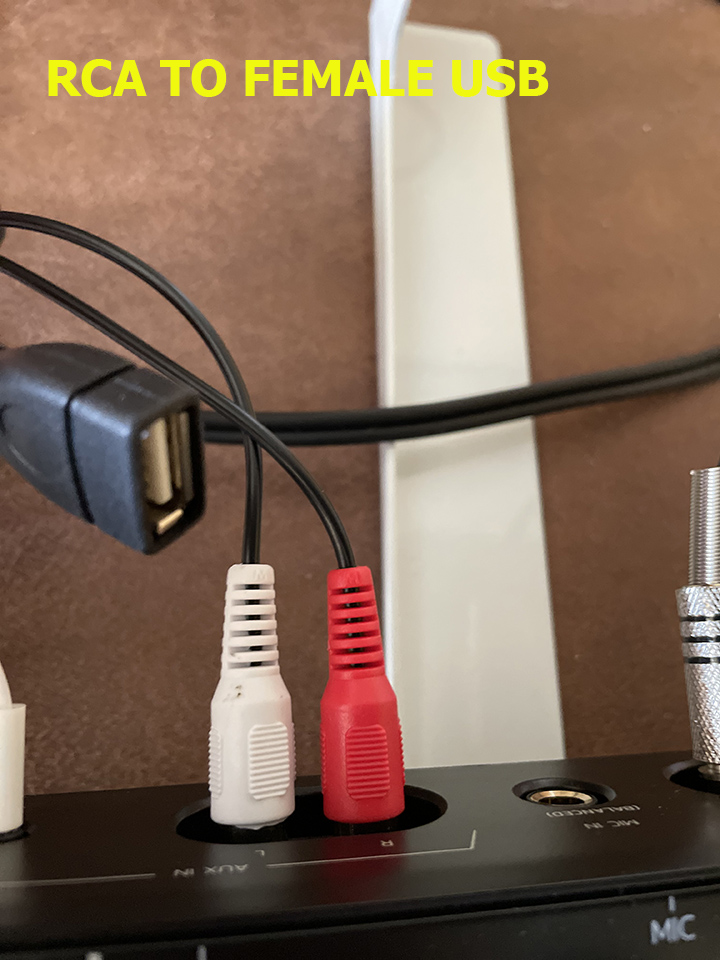

Hi
IF I plug the RCA cable into the AUX port, It does NOT show up as a drive to access the music on it...

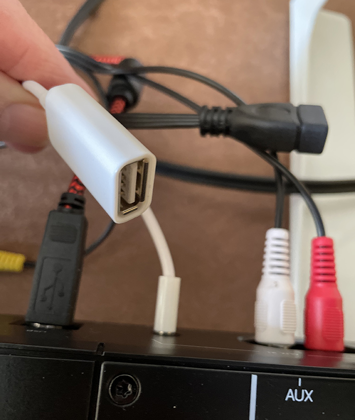

As I said I just tried that and it doesn't show as a drive ...as I showed earlier no light comes on....on the USB as it can't see it....I've tried 3, and a Phone and a External HDD
But its easier than you might think. Just connect to aux at the back, and use aux volume knob at the mixer :

therock007 wrote :
HiIF I plug the RCA cable into the AUX port, It does NOT show up as a drive to access the music on it...
A drive is not "aux" ..
The drive can not play by itself..
Aux would be a phone, mp3 player, etc etc
If you want to access the usb drive, you need to connect it to your computer.
And you can play the music of the drive inside VirtualDJ (you find the usb drive under "local music" when connected)

What exactly are you using as aux?
It needs to be something that plays sound. .. For example a phone, and the music app on the phone *

Sounds like you did it correctly.. .
If the cable is connected to the headphone out on the phone and at the aux in at the hercules
Did you also use the aux volume knob to turn up volume?

So you're connecting the phone to the audio input of the Hercules with a USB cable?
You need to use the correct type of cable. Do you not have the small Lightning to mini jack headphone adapter? That's specifically for audio.
