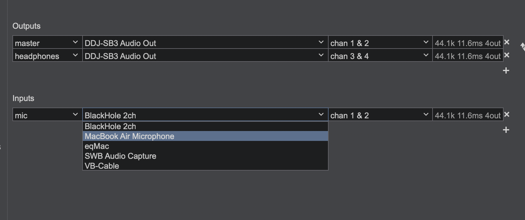

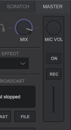

I have a Pioneer DDJ-SB3 controller. Mike plugs in on the back. I'm running Virtual DJ on a new Macbook. I hear myself in my headphones and on the speakers. But when I go to broadcast, you don't hear it in the stream at all, and I'm broadcasting through Virtual DJ into Mixcloud. In the audio panel, I can't adjust the volume or turn it on. In the audio settings, I can set up a mike input, but none of the options in the drop down menu work (FYI-I use Blackhole as my multi output device). And I don't have the option to set it up as a output, assuming that's what I'm supposed to do. Everything else is working great. Pics attached for reference.
What am I doing wrong? Help!

The SB3 sends the m8c input dorectly to the master out. It doesn't send it to the laptop. So it can't be recorded or broadcasted
Posted Fri 23 Apr 21 @ 5:25 am
You would need to loop back the audio to a line in at the computer to be able to broadcast/record the mic on that controller
https://www.virtualdj.com/manuals/virtualdj/settings/audiosetup/recordloopback.html
