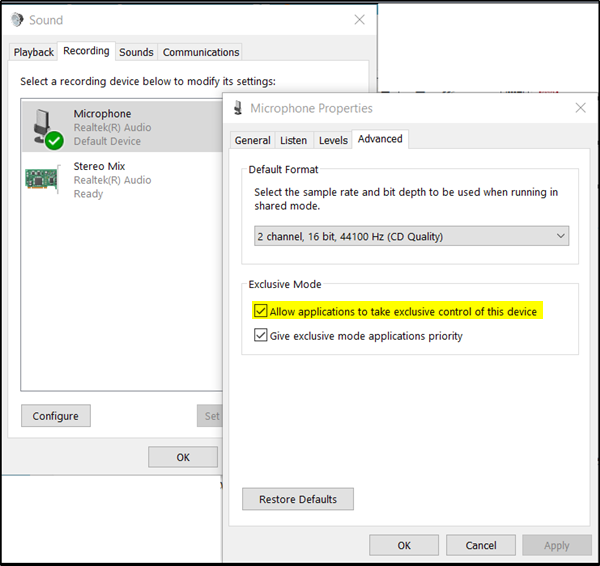

Not sure if I understood you correctly, but if the mic "stops working" it might be because the mic is already "taken" by Windows as its default recording device.
Selecting other, in windows should get rid of issue .
Alternatively you can try turn off Exclusive Audio in both VirtualDJ and Windows so that the mic is not exclusive to neither

that i checked and it is checked mark where is it in vdj?
