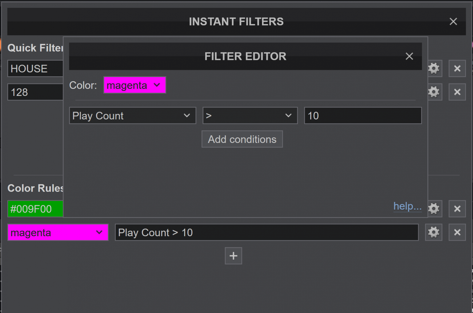

@Benz
Did you peak at the manual here:
http://www.virtualdj.com/manuals/virtualdj/interface/database/search/index.html#colorrules
Below may be a way that you could have all tracks with play count greater then 10, Magenta
(adjust colors and play count to suit your needs)

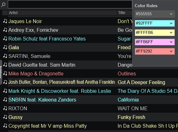

djles.co.uk wrote :
My next problem was to find a colour
😉 I've settled on a pinkish/salmon colour as displayed in the online manual.
Personally I think pastel colors works best.. . subtle, less is more ;-)
and easy on the eye..
But if you already colored songs manually it might depend how nice that looks in combination, if you used some very "strong" colors
Posted Wed 21 Apr 21 @ 1:39 pm

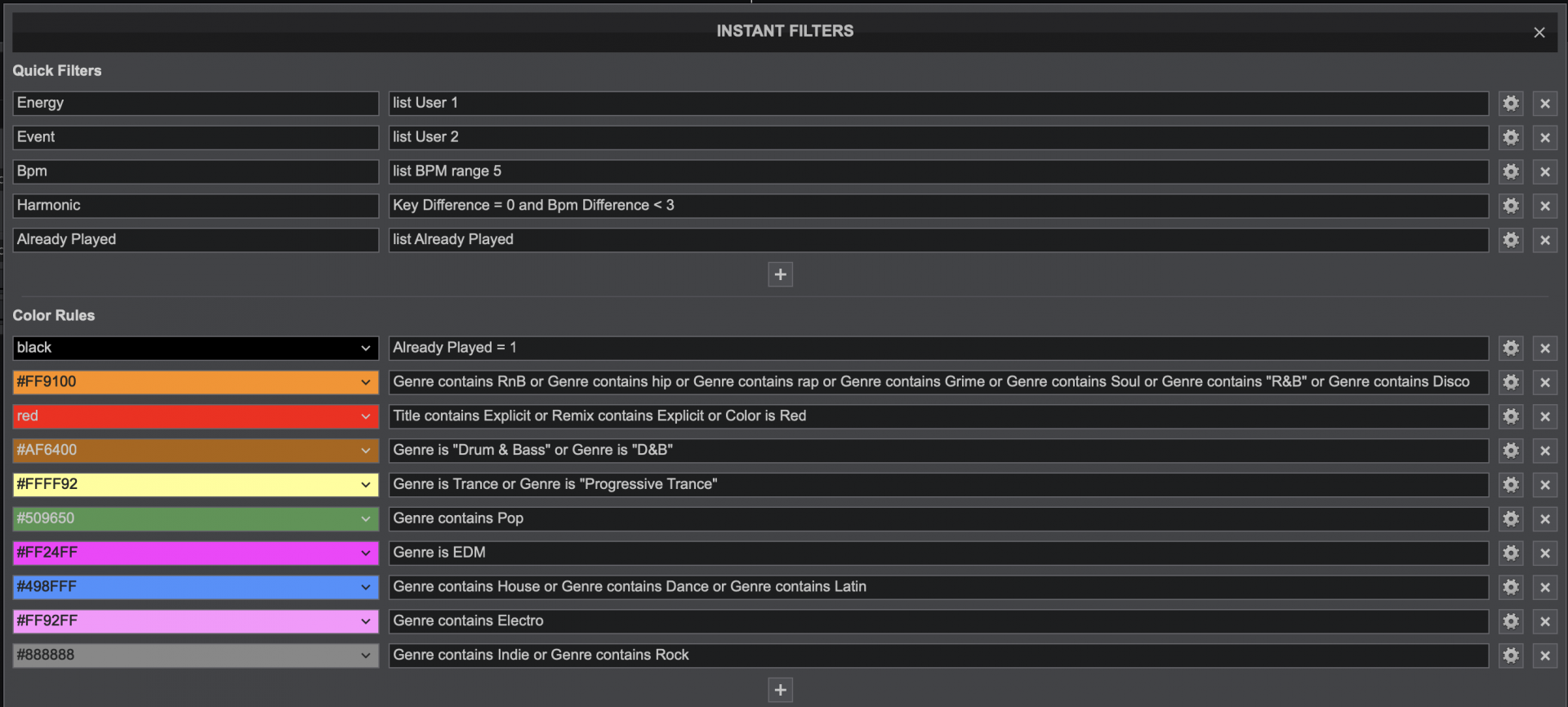

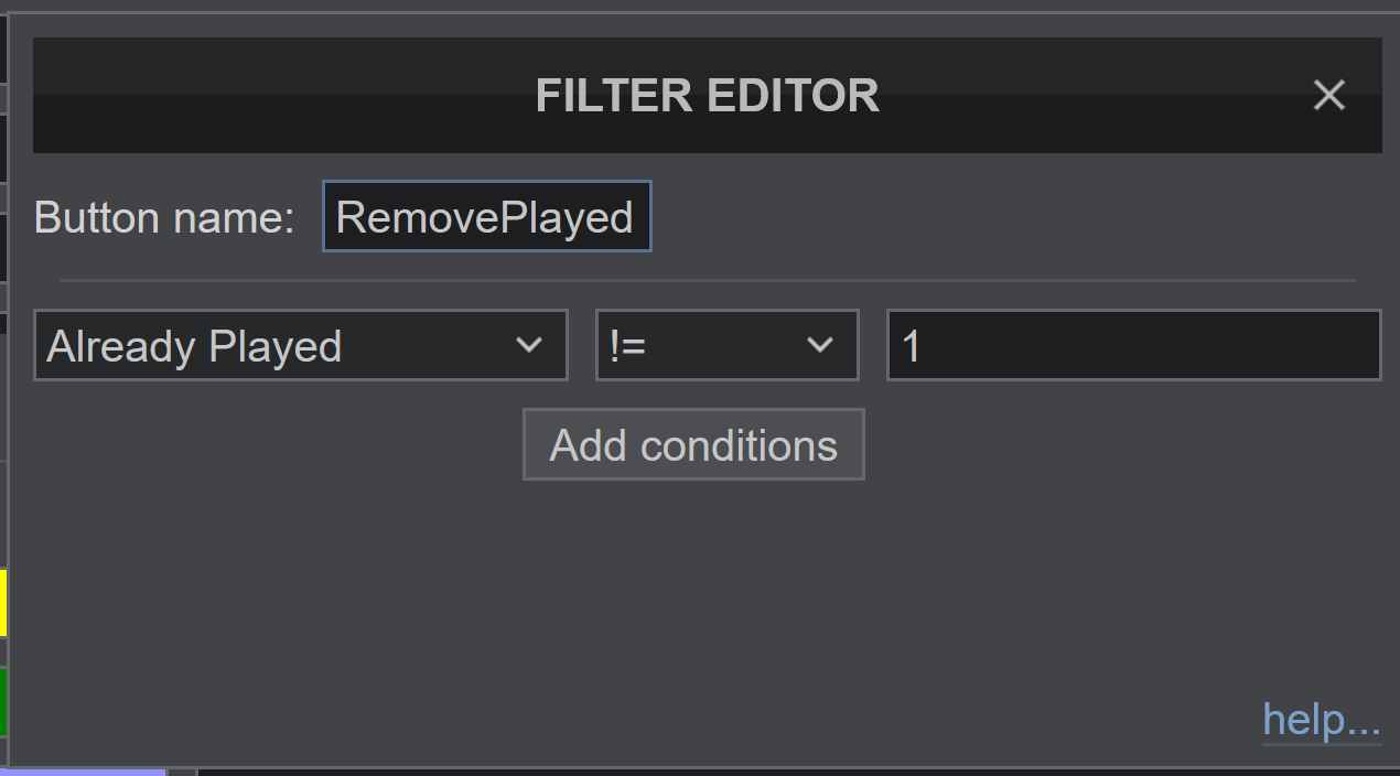

I've been waiting to see what other people do with the filters and color rules.
Meanwhile "back at the ranch" .......
I have been coloring my tracks since it was available a few years ago. This came about due to Promo Only supplying over 200 new tunes every month. I found it difficult to remember each track's style. I then created a coloring system loosely based on the Genre. This has worked well for me.
This is what I have so far, I'm still tinkering about with them;
The filters are mostly as suggested, except for the played track. I was struggling with a colour that would stand out then my partner (who was a senior officer instrumental in designing some major Counties Fire Services computer systems in the UK) said that she did not want to see onscreen Fire Tenders and equipment that was NOT available in an emergency. It was redundant useless information clogging up the system when urgent life and death decisions had to be made.
With that in mind I came up with the idea that PLAYED TRACKS colour should be changed to BLACK. That works very well, but, the black track is still visible as a gap in the browser list. The filter button for ALREADY PLAYED displays a YES or NO. Selecting YES shows only the played tracks in the browser, however, selecting NO removes the played tracks from the browser list. TADA!
This will do for now, but, I would like the played tracks to be removed automatically as already happens in the Automix and Sidelist. I will add it to the Wishes and New Features.
Feel free to copy or expand on these ideas and maybe suggest some of your own. :-)
Cheers
Les
very easy to do
Create an instant filter. Already Played != 1 and turn it on when you want them removed.
And better then sidelist or Automix , since you can get them all back with a click of a button, which can only be done this way in the browser.
Posted Mon 10 May 21 @ 7:18 am
IIDEEJAYII wrote :
very easy to do
very easy to do
That's great and does exactly what I want. I've searched the website and the manual and cannot find any information on using the operator field's exclamation mark. So, where did you find this information?
