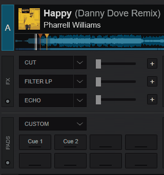

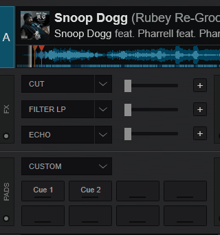

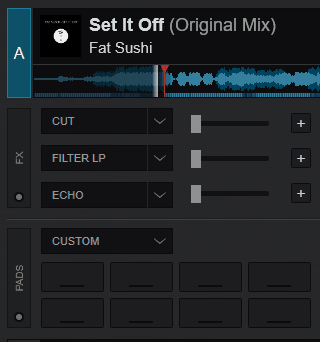

Just a color change before cue point?
cue_countdown & param_smaller 0.2 ? color 'green' : param_smaller 4 ? color 'yellow' : param_smaller 8 ? color 'red' : color 'black'
And if you want the green to last longer, say green for 4 beats...
cue_countdown & param_smaller 0.2 ? color 'green' : param_smaller 4 ? color 'yellow' : param_smaller 8 ? color 'red' : cue_countup & param_smaller 4 ? color 'green' : color 'black'
Can try on a pad, using the color value.
And can easily be used at a videoskin for something displayed on screen

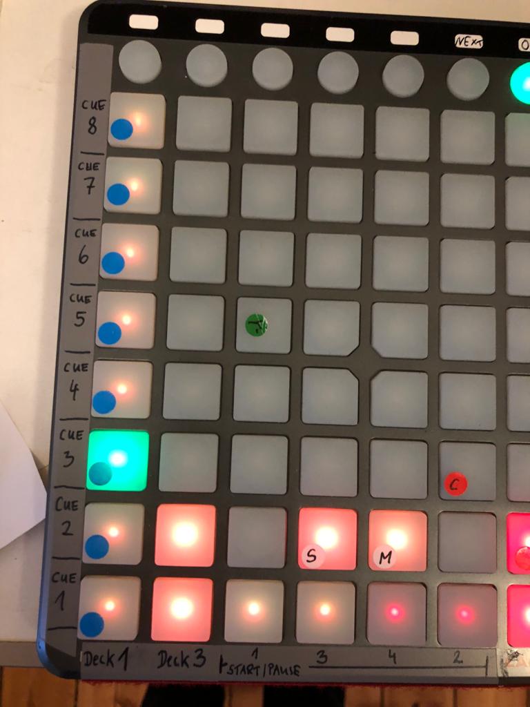

Thanks Rune, but that would be too easy.
There are 8 Lights in a row connected to 8 cuepoints.
During playback whenever one of these 8 different cuepoints is reached,
the special LED shall make the traffic-light effect.
To see, WHICH point is coming up.
But with my script only the last selected pad shows the traffics...
On the picture:
cue 3 was selected by pressing pad 3
the song is started at cue 3
Now pad 3 lights red, yellow & green, even if cue6 or cue7 is coming up.
(maybe because of the [deck left cue_select 3 ?] in my script?)
But it´s necessary that pad 6 shows the colors, when cue 6 is almost reached.
And Pad 7 for cue 7...

It works ! Another example of me trying for hours and You coding it in minutes.
You are gorgeaus! THAAAAANNNNNKSSSSS !
(hope I learned something, cause fixed a little issue)
The red light started just 6 beats before the cue instead of 8 beats.
To fix it I screw up the possible difference between cue_pos and song_pos
param_smaller 0.01 ? param_bigger -0.01
to
param_smaller 0.02 ? param_bigger -0.02
So You see: I´m a docile student ;-)
