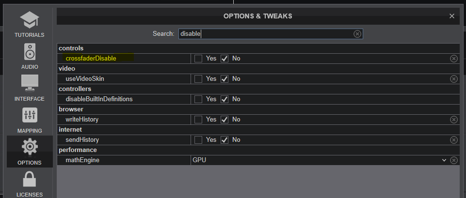

search for crossfaderDisable in settings

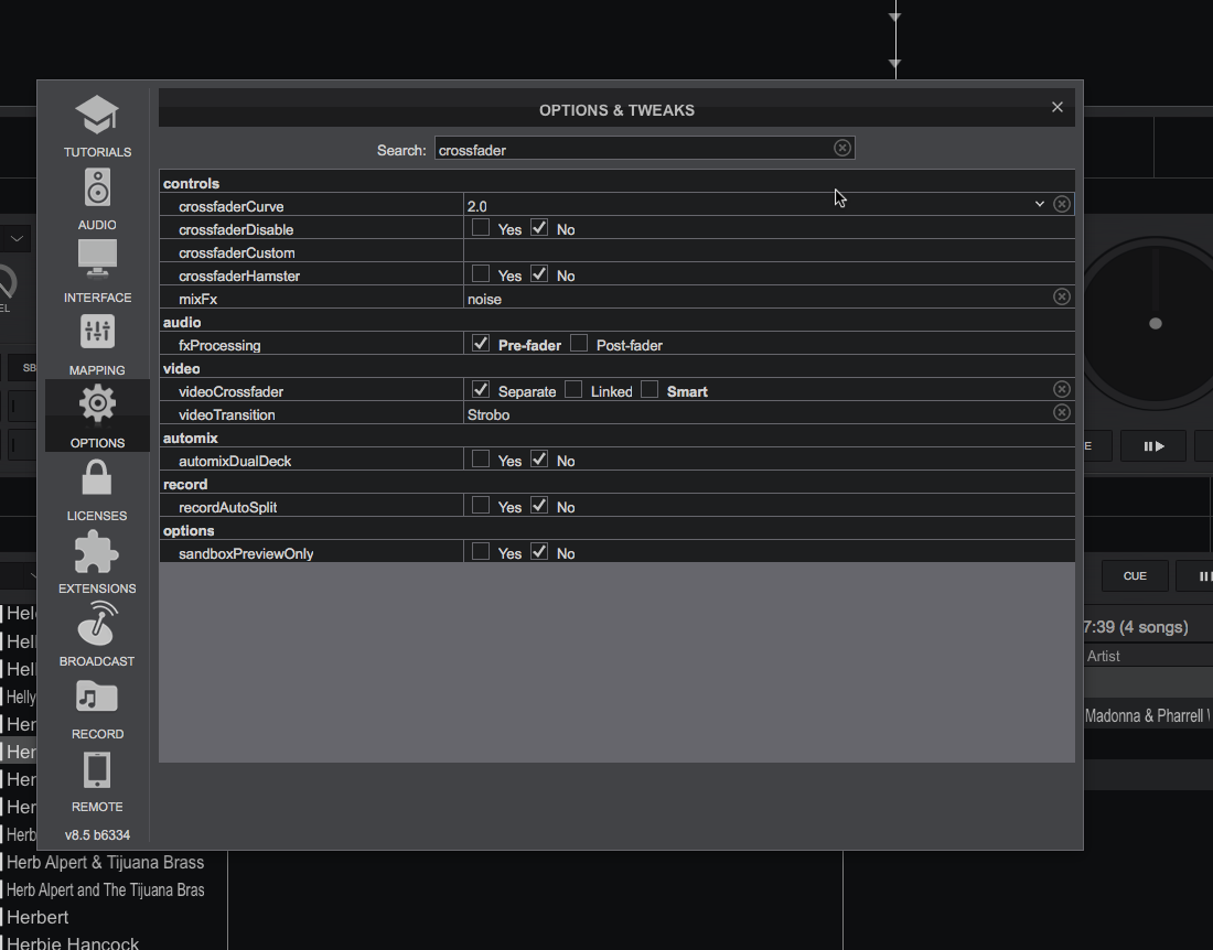

Little unlikely that you changed that in settings (without knowing at least), but who knows.. if your audio settings and the rest is correct, it could be that you disabled the fader.. .
Just search "crossfader" in the setting options
Posted Tue 13 Apr 21 @ 4:15 pm
Posted Tue 13 Apr 21 @ 4:26 pm
not sure how you got a "2" as your crossfader curve but it's probably that, select a predefined choice
Posted Tue 13 Apr 21 @ 4:35 pm
click the (X) to far right at the crossfader curve to clear that setting
To do that you simply have to delete settings.xml in the /documents/virtualdj/ folder before you start the software
