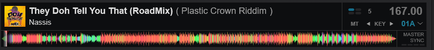

In the deck information tab, I'll like to see information from the album and the comment tabs instead of the remix and feat. tab in the performance skin. Now for the remix tab, I've tried changing the "get_remix" to the "get_album" and replace "remix" with "album" however, the deck display info tab was blank. I'm not sure about the feat tab...

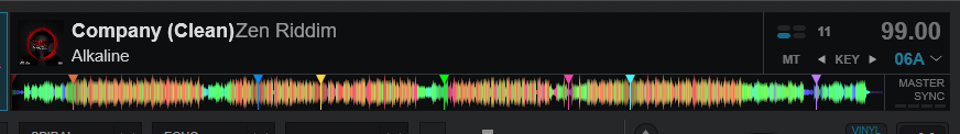

Thanks... However, it didn't work. more changes were needed.
Wrong
<text fontsize="18" color="title" weight="bold" action="get_title_before_remix" important="true"/>
<text fontsize="18" color="remix" action="get_album_after_title" important="true"/>
Correct
<text fontsize="18" color="title" weight="bold" action="get_title" important="true"/>
<text fontsize="18" color="album" action="get_album" important="true"/>
The only question I have now is can I space them out...
Posted Mon 15 Mar 21 @ 11:18 pm

BOOM!!! It works thanks...

BOOM!!! Thanks... It worked...
<text fontsize="18" color="remix" action="get_album & not param_equal '' ? get_text ' ' " important="true"/>
<text fontsize="18" color="remix" action="get_album" important="true"/>
<text fontsize="18" color="remix" action="get_comment & not param_equal '' ? get_text ' ' " important="true"/>
<text fontsize="18" color="remix" action="get_comment" important="true"/>
