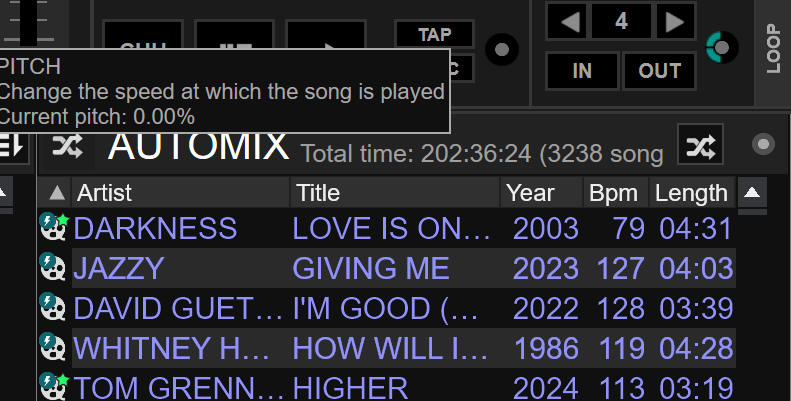

As I can see this has been asked here some times, yet I dont get why this is not in VDJ yet.
I know automix will show me the length of the songs I put in, but if I have multiple playlists (which I do), then I need multiple steps to find out the length of each playlist.
So I wonder what is the reason NOT to show the total length of a playlist (virtual folder)?
For me it would help me a lot as I dont use VDJ to mix songs but to play them in the length they are. And I need to plan ahead with the total lenght of all of them.
So again, who would be hurt if you show the total length of a playlist just like you do in automix?

Can be shown in a few ways..
At your playlists click CTRL+A to select all the songs in the list, right-click and open tag edit.
Total duration of the playlist is shown at bottom

Sounds like you're looking for some sort of radio automation software rather than DJ software.
Anyway all you need to do is ctrl+a and drag the tracks to the automix window to get the total time.
Now THAT was a neat trick to learn, thank you!
I would like to see playlist length in browser window too. There is plenty of room in the status bar, right after where the number of files is shown. Which in itself is pretty useless, but the more the info the merrier so please do not consider removing the number of files :) I am currently looking at the playlist that says it has 27 files. Nothing can be decided from that number. But as your neat ctrl-a/Tag trick would tell me the playlist total duration is 03:11:14 which gives me indication that a 1.5h set can reasonably easily be played from that list.

'Will play at' takes automix settings into account, so it's not exactly the same as sum of length.
