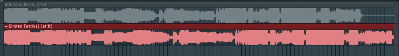

This just happened to me as well very annoying as it was a 40 minute mix
The top file is the unedited file. The bottom one is one that I stretched out to the correct bpm by lining the actual end of the track to the end of the original file. When I did that, it lined up exactly as it should at the correct BPM. But heres the strange part, the video got recorded correctly, only the audio got sped up. Because the video lines up with the new audio that I manually stretched.
Its worth noting that I clicked stop record as soon as the last song was totally over, you can hear the audio cut and as soon as the audio hard cut is when I pressed stop on the video record, but on the file its got that absurdly long tail. When I took a test video of a 20 second clip, it came out normal, and in the past I have recorded as long as a 10-12 minute video with no issues. Does Virtual DJ just kinda, fail, once you hit a certain threshold?
Posted Sat 22 Jan 22 @ 9:52 am
