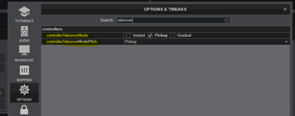

Its a feature to avoid accident (when software fader and hardware fader does not match).
Say you press sync in software, the pitch fader on hardware doesnt have a motor to change position, and without this feature on the pitch will jump to hardware position as soon as its touched..
But, the feature can easily be turned off if you prefer to have it be instant to hardware movement and not pick up position in software.
In software settings, options, search for "takeover" and set controllerTakeoverMode to instant

This is perfect. Thank you so much!
