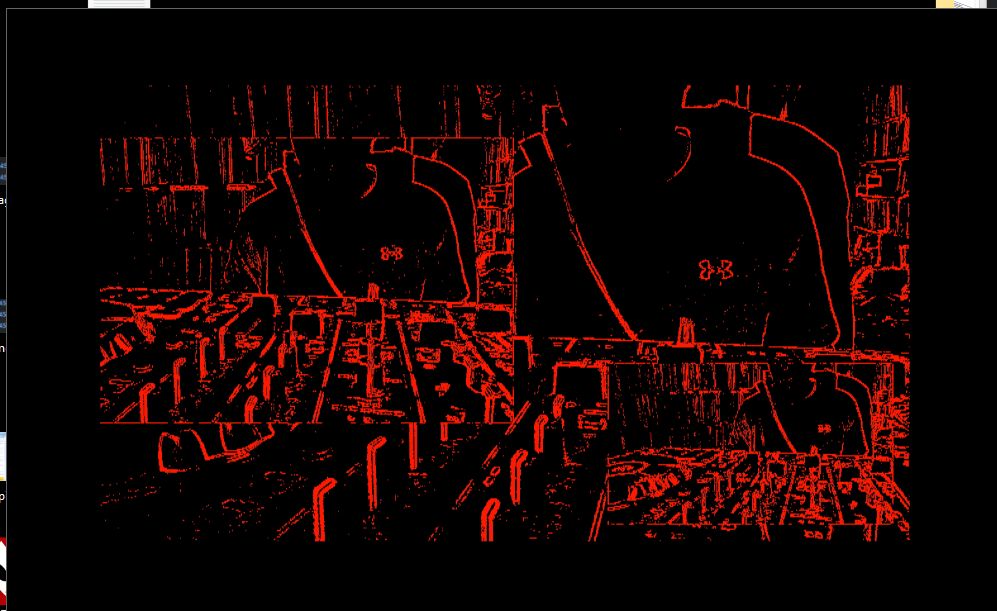

On a related note, I just noticed that although the video camera appears in VDJ, it only fills part of the VDJ "screen". There is a large black frame around the video within VDJ. Previously my cam output filled the VDJ frame.

Thanks again but unfortunately that solution did NOT work. The video position was already set to fill the frame.
I went to the "letterBoxing" setting in VDJ and changed it to "crop" from "bars". That resulted in my video filling the frame.

When previously applying position and size to the image from the camera
it now apply them to image resized to fit in preview ratio with preview size
in fact this depends on ... main VDJ size or video preview size
i now have 2 lateral bars when i use a 4:3 image from camera
when before i was able to distort/truncate it to cover the screen
it now only can take the height of the screen and can't reach corners because size is the size of video preview with camera centered in it not the size of the camera image itself
