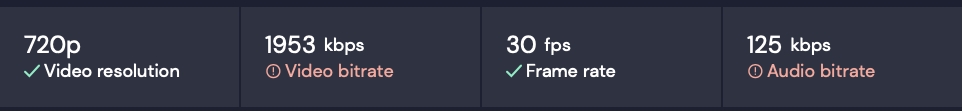

I broadcast to Mix-Cloud and I am having trouble customising the settings
Video Bitrate, it should be between 2500kbps to 3500kbps, I am currently broadcasting 1953kbps with the default settings. My Audio Bitrate I want at 320kbps. I am currently broadcasting at 125kbps!
Can you please tell me how to change these in VDJ as I can't seem to find this anywhere.

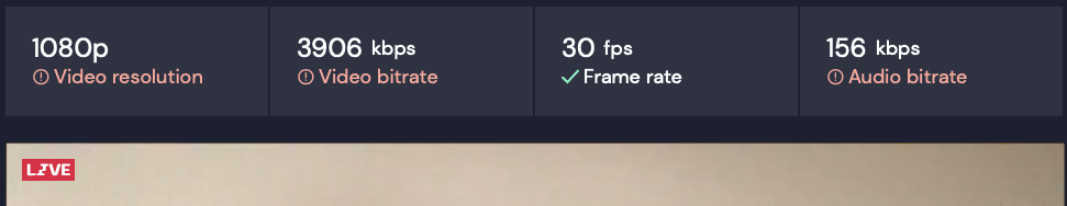

If I choose the HIGH setting, MIX Cloud will stop the broadcast because of the video Rate being too high, I get kicked off and the !!!!!!
Video Notification
Video bitrate notification

If I choose MEDIUM SETTING, I get a performance indicator from Mix Cloud stating that my Video and Audio is not optimal.
Video Notification
Audio Bitrate notification

All of them are just notifications.. such as 1080p they will downscale to 720p, and that they have 320 available bitrate for audio. All should work fine though, plenty of VDJ users on Mixcloud all the time ;-)
That being said, you can also set custom broadcast settings in settings as well
But shouldnt be needed (And maybe preset for mid should be upped to 2500 bitrate)
Posted Mon 15 Feb 21 @ 3:30 pm
We'll adjust the bitrate and resolution used for the high quality setting in the next update.
In the meantime, you can use a custom quality setting and set it to
1280x720@3400,320 for example
