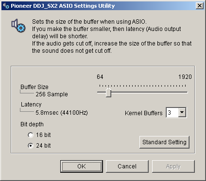

Then all you need is probably just set a higher buffer in the Pioneer Asio driver for the DDJ-SX2.
Drop outs are common when the buffer runs empty. (Although not for 1-2 seconds perhaps)
Try a buffer size of 256 samples or even 512 if needed..

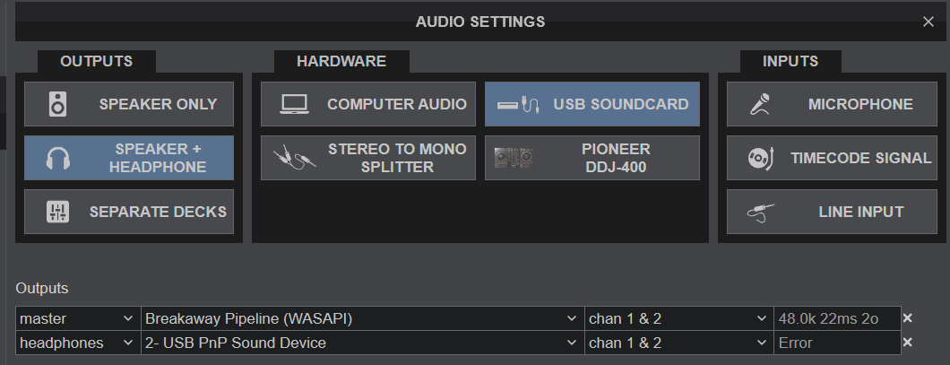

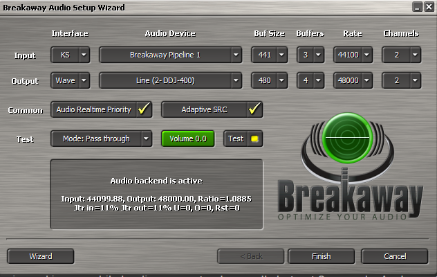

Similar issue last night I think (using DDJ400 controller). Drop outs when dragging a new file into Explorer music folder that was the same folder that the currently playing track was stored . Stems were on and Mathengine was on. My settings are below. I use Breakaway Audio Enhancer as kind of a "pipeline" audio routing software to improve sound. I had its output at 41000 but after reading this I think it should be at 48000. .
