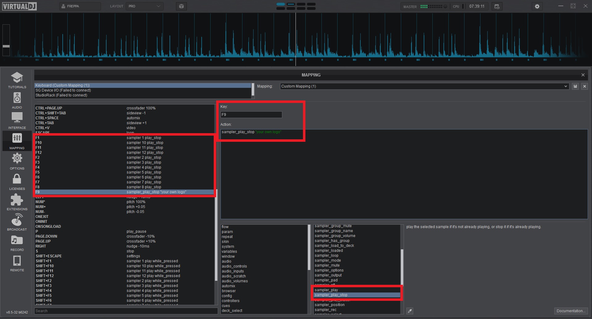

Below you get a picture how to do the setting.
Add sample in the sampler section, use the sample name in the script inside like this example , sampler_play_stop "my logo"
A tip is if you edit the sample to loop it will contiue to loop.
The best part with this script is, you dont need to be showing the right sample window to trigger it.

Thank you for sharing,
I could NOT get sampler_play_stop "my logo" to work reliably unless, the sample "my logo", was in the the active sampler window.
Is there a place required for the sample, "my logo", to be placed, for it to always work.
OR
can the sample Bank be incorporated into the address for the sample?
For example sampler_play_stop "Bank A" "my logo" or sampler_play_stop "Bank A/my logo"
Thanks in advance
A work around would be to add the sample, "my logo" to every sample bank.

The sample doesn't have to be called My Logo - that was just an example. You can call it whatever you like, and it can be located anywhere. Just add the path to the command.
sampler_play_stop "C:\Users\IIDEEJAYII\Music\Samples\this can be called anything.mp3" (example only)
Posted Sun 07 Feb 21 @ 1:43 pm
Thank you GroovinDJ
That worked perfectly..
Thank you for your awesome help as always.
