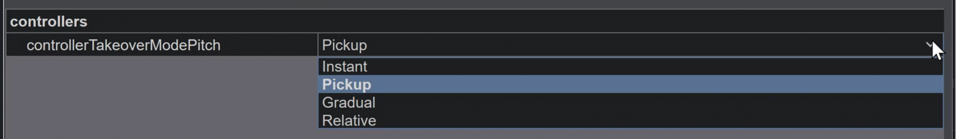

search for setting "modepitch", study your options. No matter which you choose it's a compromise.

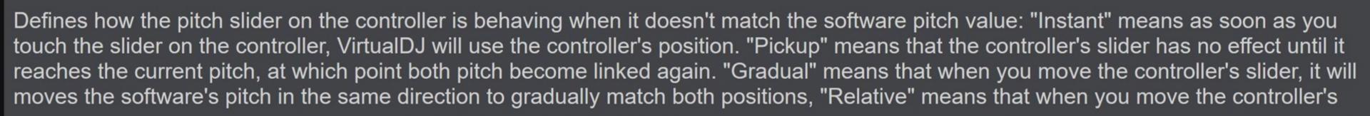

As Locodog has says, you need to decide which mode you prefer for "controllerTakeoverModePitch" in options. Each have pros and cons.
Sounds like you have it set to "Pickup", which is what I prefer. You can choose any of the possible other modes.
You may also want to look at this Wiki page which discusses this:
https://www.virtualdj.com/wiki/Soft%20Take-over.html
