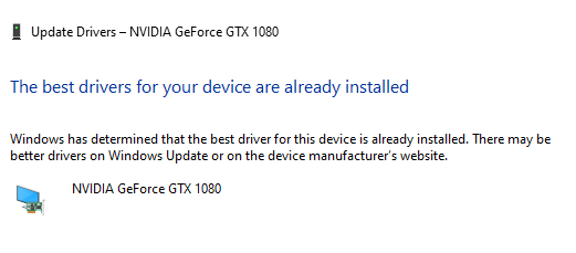

Running 6280 on my Alienware says my graphics drivers are out of date and disables GPU accelerated features... Windows device manager say's I have the most up to date driver and GeForce experience app also says I have the most up to date driver too.
Posted Thu 28 Jan 21 @ 4:20 pm

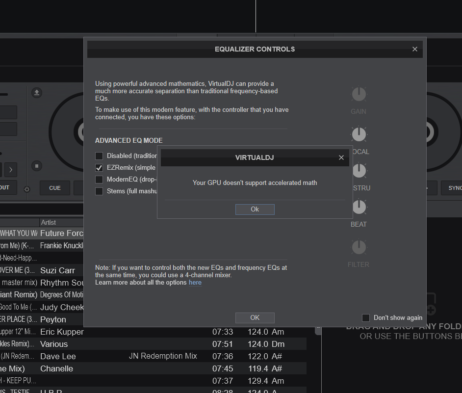

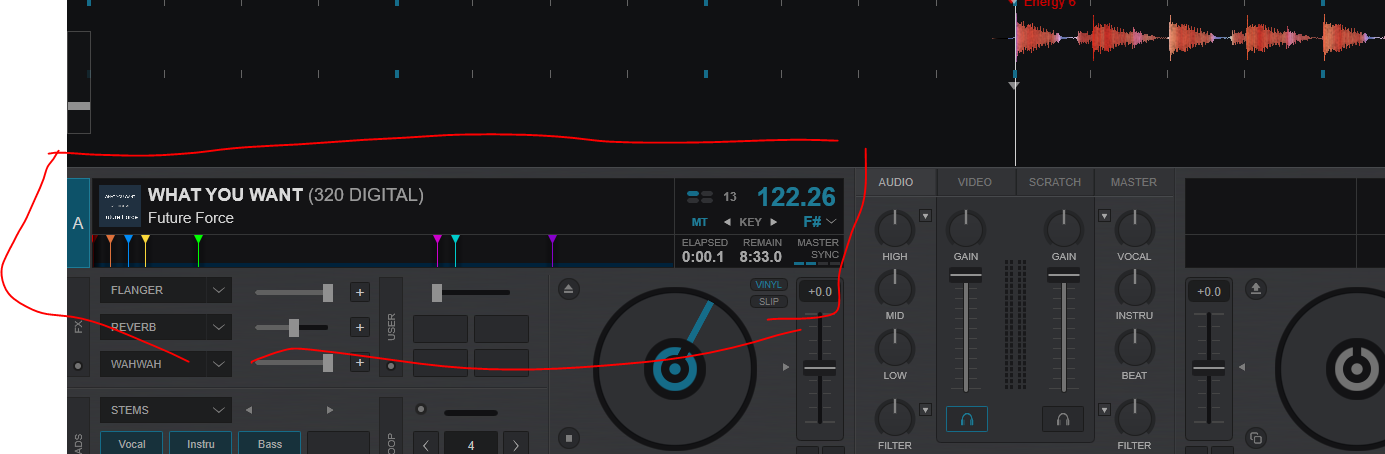

6281 pops up at the start and says that my gpu doesnt support accelerated math... once that dialog is closed I then see another dialog with a green progress bar... I think this is downloading the compute shader for the gpu accelerated functions? once that dialog is complete mathEngine is set to GPU but I then see yet another dialog that states my GPU doesn't support accelerated math... The smaller preview waveform is missing but the main waveform is present.
Posted Thu 28 Jan 21 @ 5:05 pm
If the download is complete, try to restart vdj. Do you then still get the incompatible popup?
Posted Thu 28 Jan 21 @ 5:09 pm
yes I tried restarting, didn't get the green progress bar again but it still moaned about my GPU being incompatible and didnt work
Posted Thu 28 Jan 21 @ 7:10 pm

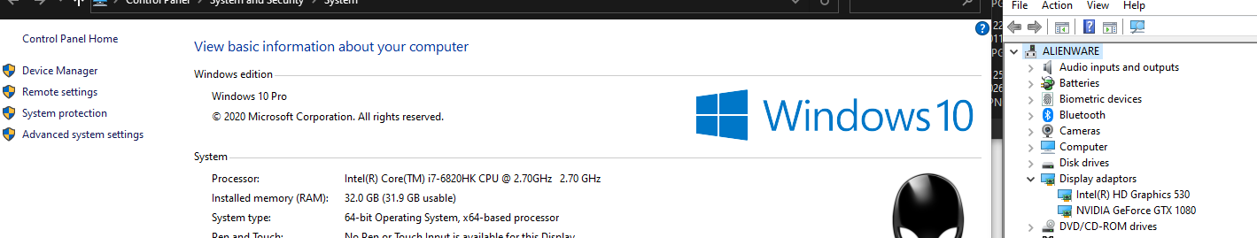

is it something to do with how the graphics cards are enumerated? This laptop has two different GPU's and my attic machine might also have onboard graphics enabled, I would have to check.
Maybe its just picking up the first gfx card in the list?
Posted Sat 30 Jan 21 @ 4:34 pm

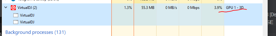

Task Manager shows this
Posted Sat 30 Jan 21 @ 4:40 pm
If you upload a build with verbose logging enabled I can send you the log file if that helps?
For stems it doesn't matter which one is selected, it will always use the nVidia.
Try to set mathEngine to Automatic again and restart.
Posted Sun 31 Jan 21 @ 6:28 am
I had math engine explicitly set to GPU... switching that to Automatic as you suggest fixes STEMS and waveforms on my GTX 1080 Alienware.
Posted Sun 31 Jan 21 @ 10:49 am
After another restart, does it show GPU or CPU being used then (in the mathEngine setting)
Posted Sun 31 Jan 21 @ 11:04 am
oh... its set to CPU... flipping it back to GPU brings up the "Your GPU doesn't support accelerated math" dialog
Posted Sun 31 Jan 21 @ 11:37 am

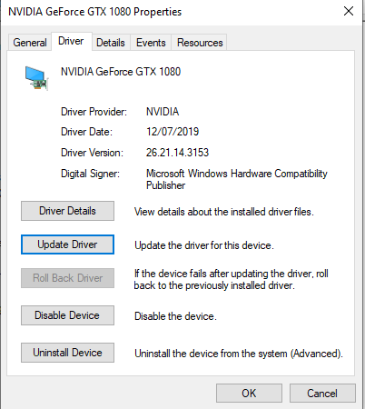

Which version of the nVidia drivers are you using?
Posted Mon 01 Feb 21 @ 10:46 am
one from 2019 apparently
Posted Mon 01 Feb 21 @ 12:45 pm
