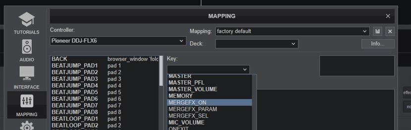

But the mapping slots are there - so while you wait for it, you can map some stacked effects yourself if you like:
Posted Fri 22 Jan 21 @ 9:34 am
How do you properly map stacked effects into merge then ?
Posted Sat 23 Jan 21 @ 4:27 pm
Just like you would on a custom button and a custom slider
You could for instance do
effect_active 'echo' & effect_active 'flanger' & effect_active 'noise'
on the MERGEFX_ON mapping slot to turn 3 effects that you like on and off and thereby stack them
and then do
effect_slider 'echo' 1 & effect_slider 'flanger' 1 & effect_slider 'noise' 1
on the MERGEFX_PARAM mapping slot to change their first/main slider at the same time, and there by turn their intensity up and down
You could also make different combinations and use the MERGEFX_SEL mapping slot to switch between them, but that's a bit more work
The downside is that you can't just change which effects are stacked in the middle of your set - you need to change the script for that
So this is just meant as a way to get started until the real mapping for the merge effects has been added

I don't own a FLX6, so I have created an example with the 2 scripts above using a custom button and a custom slider instead -, so you can see the kind of result you can expect when mapping it on the merge fx on the FLX6
