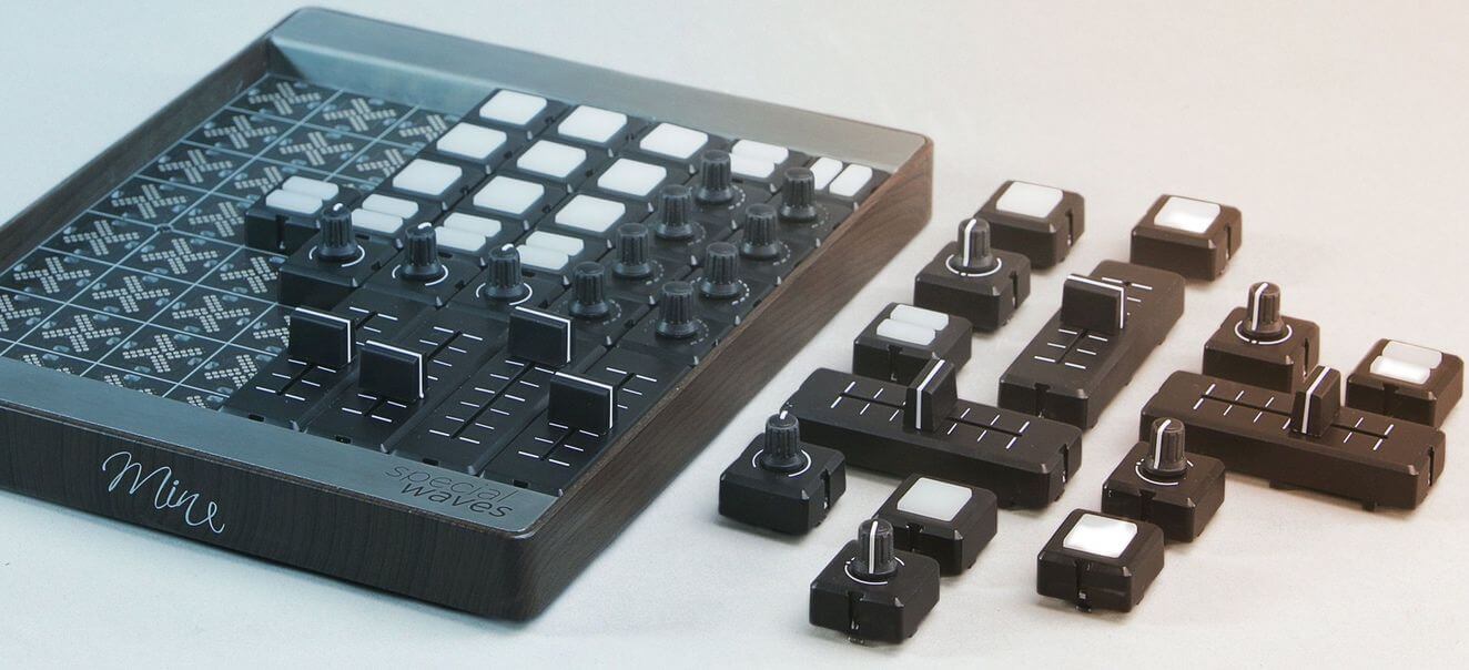

Not sure if its as DIY as you had in mind, but the Specialwaves one comes to mind...
https://special-waves.com/
Posted Sat 07 Nov 20 @ 10:08 am
I was looking at that, but once I configured it to be a Stems controller I was up to like $500.

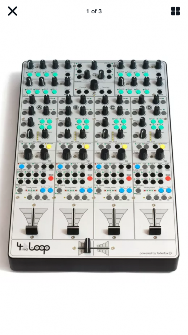

Maybe this one ☝️
Posted Tue 10 Nov 20 @ 7:52 pm

the SOUND INSURGENT wrote :
Maybe this one ☝️
Wow
I looked for 4midiLoop DJ Controller
227 controls:
» 47 Potentiometers
» 9 Push-Button Encoders
» 152 LED's
» 166 Push buttons
» 5 Eclectic Breaks Pro X Faders
Here is review I came across https://futuremusic.com/news/testdrive/4midiloop-review.html
from 2011
the 4Midiloop.com website is is now a placeholder, seems company may not around anymore,
Love it, if only it was available and around $500
Posted Tue 10 Nov 20 @ 9:54 pm
