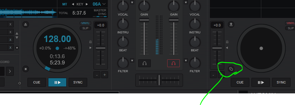

if you want to keyboard map as serato (that has two keyboard keys for it if i recall), you can specify what deck to clone to/from
deck left clone_deck
deck right clone_deck
Or you can just click the clone button in skin
