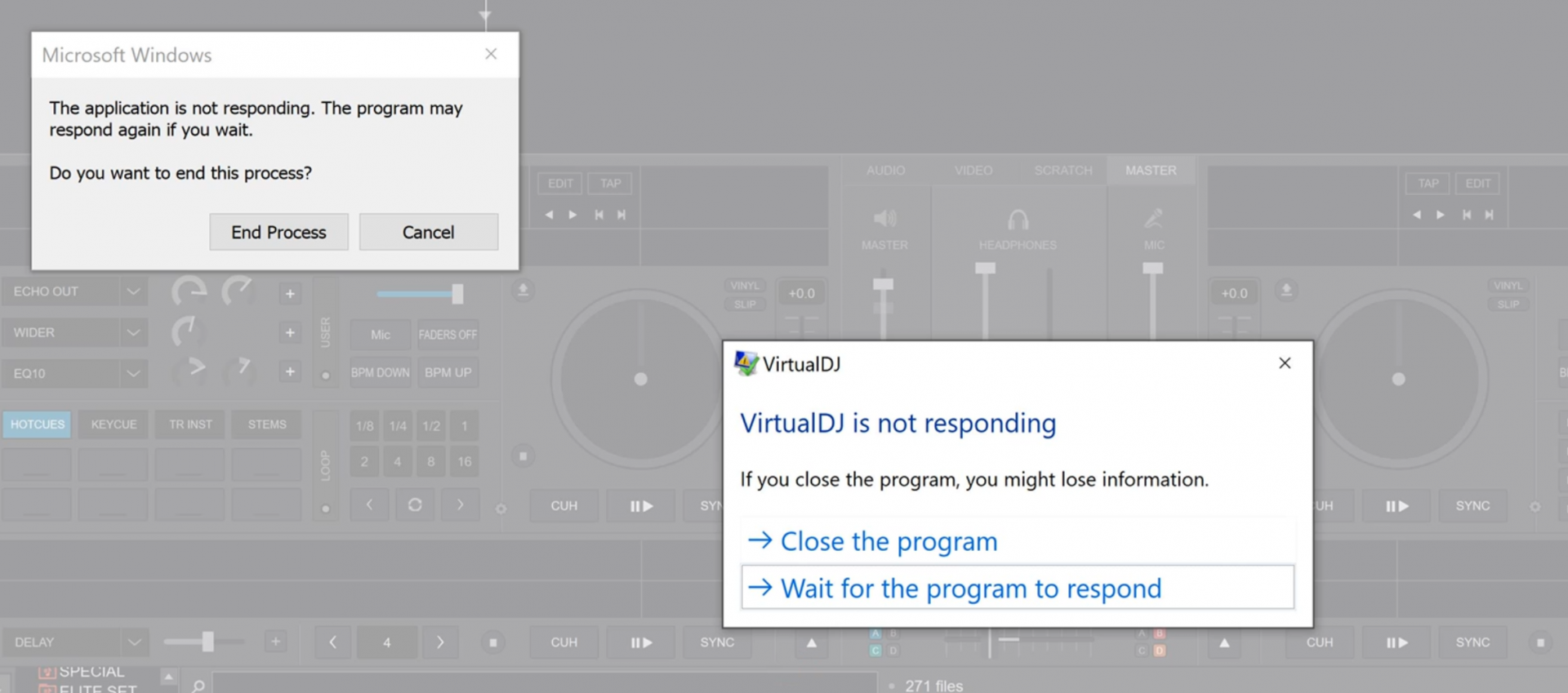

Posted Tue 03 Nov 20 @ 3:11 pm
Thank you Rune.
I have tried that alone the lines of the thinking.....
and one of the differences is that VDJ writes that wider.ini file on closing. But removing it, deleting the wider.ini file, did NOT allow the plugin control panel to open. Only removing the plugin also and allowing VJD not to see the wider plugin once, so it could then be added back, and VDJ seeing it as a new plugin, was the only way to get it to work, from my experience.
I also tried moving the wider.ini file to one level up to the C:\Users\myuser\Documents\VirtualDJ\Plugins64 where all the native plugin *.ini files are, that did not work either. (grasping at straws, so decided to ask for advice)
FYI
The wider.ini file contains 2 lines
[autoparams]
Slider Amount 0=2257
and here is screen shot of the Hang of VDJ

Posted Tue 03 Nov 20 @ 5:33 pm
Thank you Nicotux for confirming. And yes I installed the ONLY the 64-bit VST2 wider.dll in the
C:\Users\myuser\Documents\VirtualDJ\Plugins64\SoundEffect folder.
(I don't have a subfolder VST as you seem to indicate. and my path does not have plugins[64] just Plugins64)
And your BSOD is much worse then the hang of VDJ (becoming non responsive) that I experience.
To test if it was only a Master effect that was causing the problem, I removed Wider from selected Master effect, and tried to open the GUI for Wider on Deck 1 , (4 different way, using Fx multi-mode in all 3 locations, and in single mode), and when I click the + to open the GUI, VDJ hangs and have to force to close since not-responding ( in all the 4 cases tested, even with Master NOT set as Wider).
again here is Screenshot of the Hang on Windows 10.

Unfortunately the VST stops working after a while - I can turn it on and off but it has no effect on the audio and I have to restart VDJ to get it back. (Not sure if this is related to the above, of course, I didn't try to display the VST GUI.)
Posted Sat 07 Nov 20 @ 4:43 pm
Did you try using the VST in other software (a DAW etc)? Maybe it's the VST itself which is unstable.
Posted Sat 07 Nov 20 @ 4:45 pm
Could be, seems like a well developed VST but I didn't, I'll report back.
Posted Sun 08 Nov 20 @ 8:46 pm
UPDATE: ISSUE SOLVED
early release BUILD 6173 (2020-11-23) Fixed the issue of the VDJ hanging/freezing, when opening the GUI, (the second time one started VDJ)
I once again added the VST2, 64 bit version of Wider ( Wider.dll) VST to VDJ's Documents\VirtualDJ\Plugins64\SoundEffect folder, to add the VST to VDJ, and it works flawlessly.
Thank you
LOVE VDJ ! !
don't think there is another DJ software that one can add cool VSTs.
Thank you
LOVE VDJ ! !
Posted Mon 23 Nov 20 @ 6:12 am
