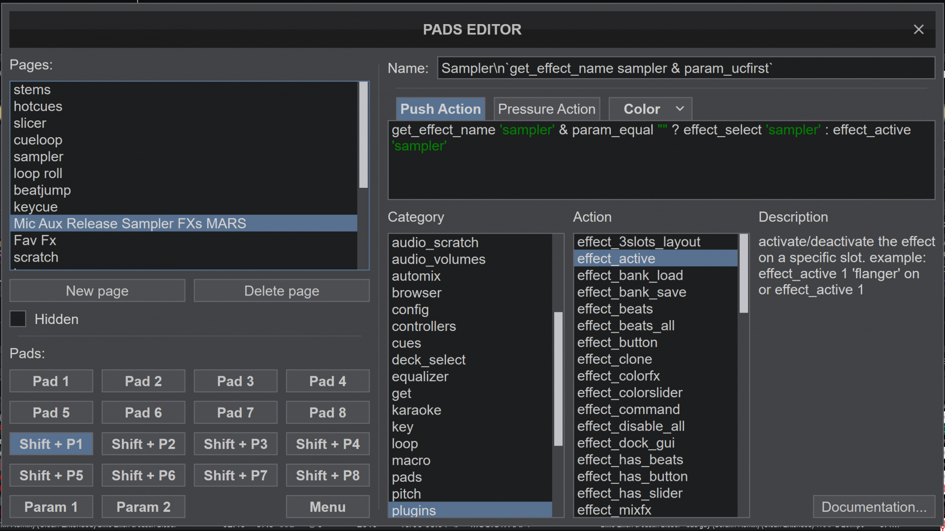

          Hi  Nicotux
Could you confirm this behavior or is it expected.
When I right click the Mic effect button (Pad 1), the track on deck will play from what ever stopped position it is at,
a second R click stops play, and returns the play position back the original stopped position.
(and 3rd R Click on pad 1 will start play again and so on)
Also, Deck 1 plays if I click Pad 1 of deck 1, or Pad 1 of Mic Aux Release Sampler FXs (MARS) of deck 2, the track on deck 2 never plays.
I have tested using the default Pro skin with a few different VDJ stock effects, and no controller connected .. restarted VDJ and tested again. Same behavior.
the script for the shift Pad 1 is :
I don't understand how this is possible.
Summary:
The R Click of Pad 1 plays the track that is loaded on Deck 1, no matter which deck the Mic Aux Release Sampler FXs (MARS) addon is located.
Behaves like some form of Cue.
Let me know if you need more information. I can take video of it happening etc.
PS I love the Mic Aux Release Sampler FXs (MARS) Addon
get_effect_name 'sampler' & param_equal "" ? effect_select 'sampler' : effect_active 'sampler'
Summary:

          Not a wanted effect, and not an effect i get here
right click is like a shift with pads, thus it do not apply to mic but to sample
padshift 1 or rightclick pad1 will both activate sampler fx
so that the action you describe can be ...the action the effect affected to to sampler does
another thing i guess is... MARS was created in mars, before the modification of pad_page and pad_page_select
maybe there is an interaction with some existing padpage (i.e. hotcue) affected to a page the controller you are using have (if any)
you can try option padSkinIndependent
badly i can't test, no controller available :\ only keyboard - can be set as controller with 4 pad page but no issue
can be a related new bug

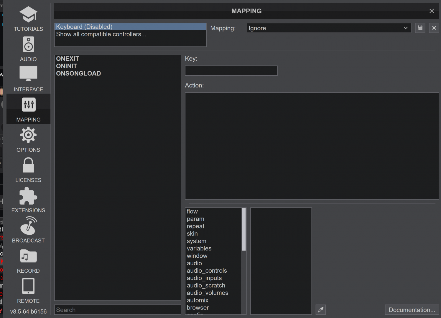

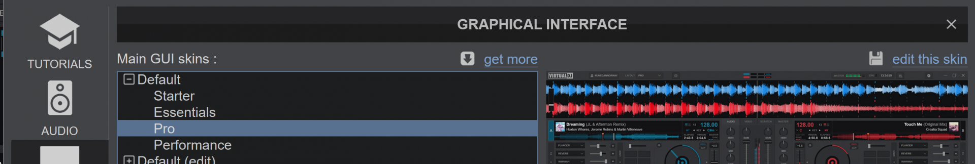

          Nicotux
I am testing with NO controller attached. Not even Keyboard being used as controller. Keyboard set to IGNORE.
And the Default Pro SKin: Tested with 2 deck skin and 4 deck default Pro Skin
Wanted to remove all possible sources of modification.

Here is Pads Editor for MARS Shift P1:
I do not understand how this is possible. some bug in the default skin or VDJ scripting language, that the scripts do not perform as written?
and Nothing happens to the selected Sampler.
Hopefully you can reproduce this behavior.

          I try to reproduce with no success :\
Intel(R) Core(TM) i5-2400S CPU @ 2.50GHz
Memory: 6.0 GB
OS Version: Microsoft Windows 10 64-bit (Build 19041.572)
Intel(R) HD Graphics
NVIDIA GeForce GT 525M
VDJ v8.5-64 b6156 w Default Pro Skin
Really CAN'T reproduce this behavior.
the only way i can simulate it is to select a sampler fx which starts the deck specifically (a "diy" or a virtualfx...)
Memory: 6.0 GB
