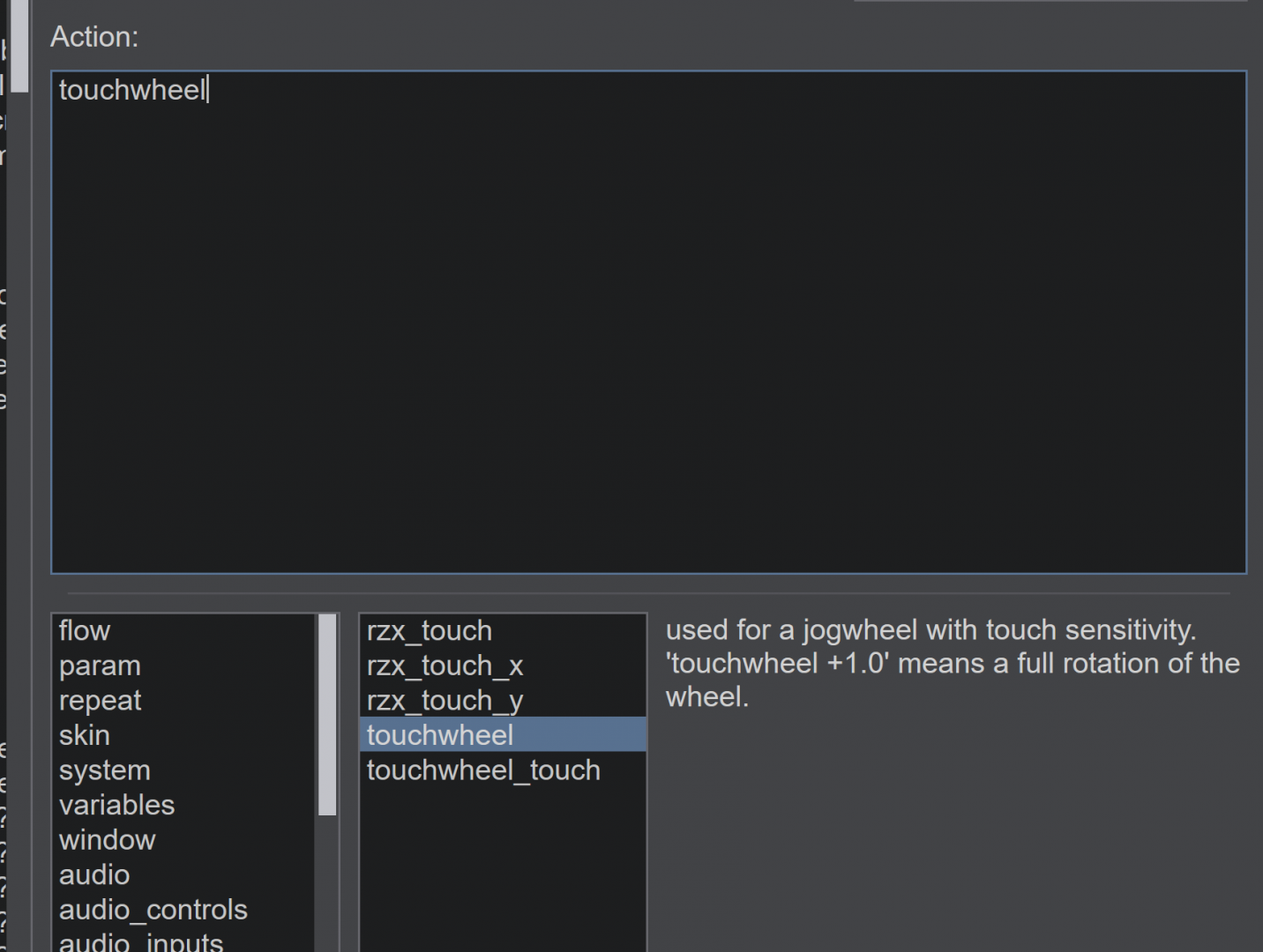

In mappers tab, when you type a command you get a description of the command.
That's always the most recent and updated description of the command.

You mean the Settings > Mapping ... and what ?
If I type touchwheel I get info I put in my first post, And yes as you say it's a description, I was interested in the allowed parameters and the parameter type, and the reason I started the thread since that is NOT documentation. It would be great if it did specify all allowed parameters and syntax there. So I assumed it is documented fully in somewhere, and again the reason for my inquire/thread.

This is the most complete documentation available.
For the touchwheel script, 'search' is indeed available as parameter but not documented. It is at the time also the only other parameter allowed.
speedwheel requires specific parameters to come from the device definition. There are no additional parameters, so unless you have an unsupported device and you are creating your own definition it should not be changed.
