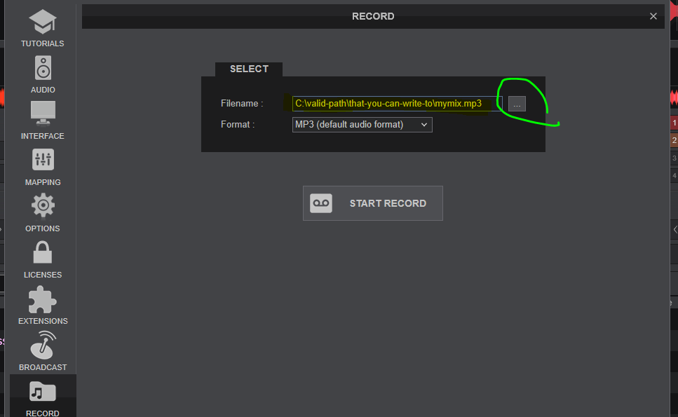

Whenever I try to record a set it's saying that it's unable to open a file for writing.
What can I do to get around this?

You're probably trying to record in a directory that's protected. Try recording to another location (directory/folder).

I'm trying to record it to my Music file in my C Drive, literally a day ago I was able to record a set and save it to the same file but now it's not letting me do it. Id don't know how to get around it

Fixed:
I tried to name my file with the "<" and ">" characters which the system does not like.
Changed the file name and allowed me to record again.

I have the same issue how i fixed?

click the ... button at end of the field to set record file name...
And pick a valid location and set a valid name

Thanks, I had a / in my title. That caused the melee.

Just had the same issue. Lasted for 5 days. Clicking the box to the right worked. Thanks Bro!

Change the Drive You Save The Files To And Create A New Folder On The ( New ) Drive
