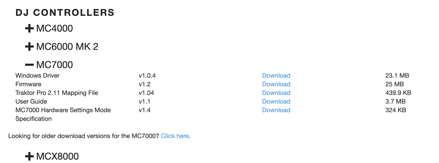

Hallo, in der neusten Firmware 1.2 kannst du die Einstellung machen!
Hier die Anleitung:
http://cdn.inmusicbrands.com/denondj/MC7000/MC7000-Hardware-Settings-Mode-Specification-v1_4.pdf

Have you got the latest firmware installed?

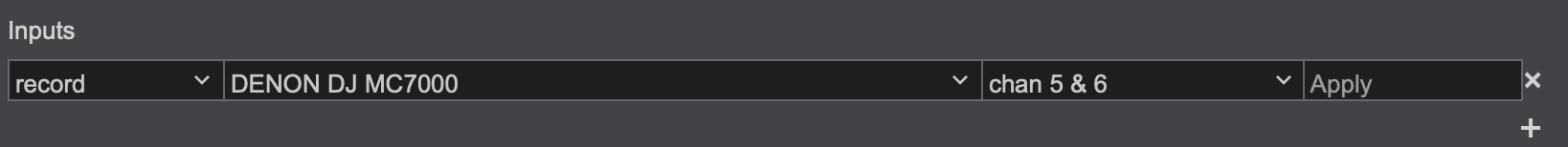

I had a similar issue.. Remove the "input" Record - Denon DJ MC7000 form the audio settings... Once I removed this, volume was better.
