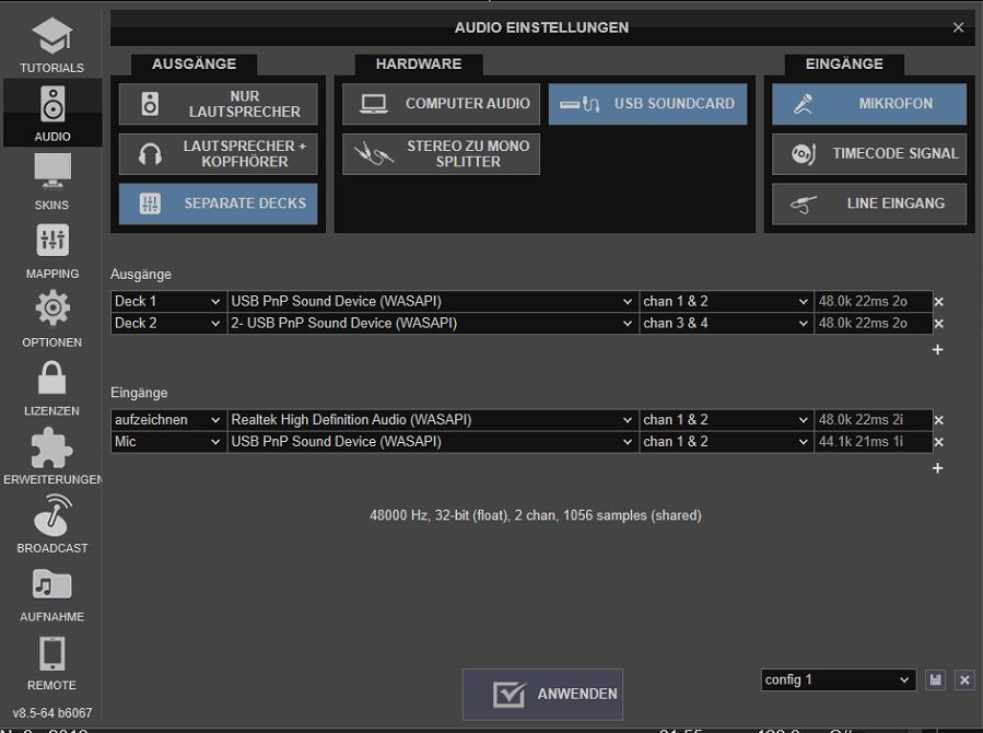

locodog wrote :
a screenshot of your audio config is the quickest way this type of thing gets solved.
Here it is, but its a mess at the moment because i tried several settings

Since you have an analogue mixer, the mixer does not control the crossfader in the software.
So the sound on the computer itself have both channels open. And sound from both decks.
Its at your mixer you are doing the actual mixing of the sound, all analogue old school way.
To broadcast the mix, you need to add a record loopback.
Basically just an audio cable from your mixers booth/rec/master output to a line-in at computer. And then in VirtualDJ sound settings add a "Record" entry set to this line-in
See here: https://www.virtualdj.com/manuals/virtualdj/settings/audiosetup/recordloopback.html
He's got that already: "Master output from the mixer connected to Line in of the internal soundcart."
Posted Sat 05 Sep 20 @ 1:40 pm
Well, if he did add record entry (loopback), VirtualDJ broadcasts the input sound. . Nothing more or less :)
Can even broadcast your XBox sound that way for that matter, VirtualDJ will simply just broadcast the line-in no matter what it is
So then you just have wrong sound to the line-in, check if other end is truly to master out/rec out/booth out at your mixer.

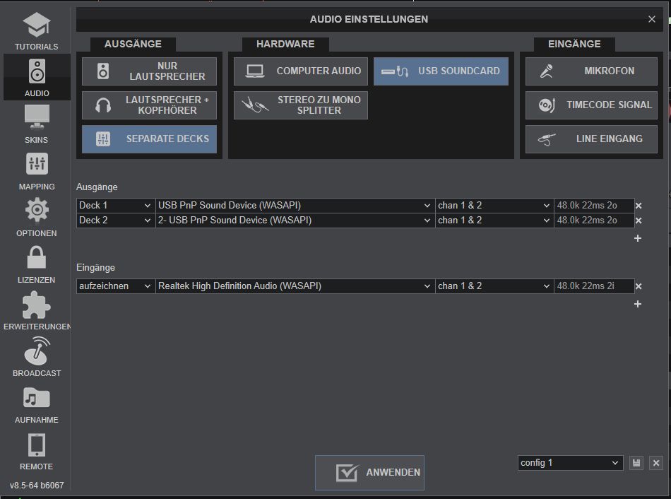

Everything is correct connected, so far it works now with the analog mixer, but if i start the streaming, i get an error , before he streamed without problems, i did not change any settings here
Posted Sat 05 Sep 20 @ 2:42 pm
What does the streaming error say?
Posted Sat 05 Sep 20 @ 2:54 pm
Hey Thanks Guys for the help, i figure it out myself and works now!!! I am so glad.
