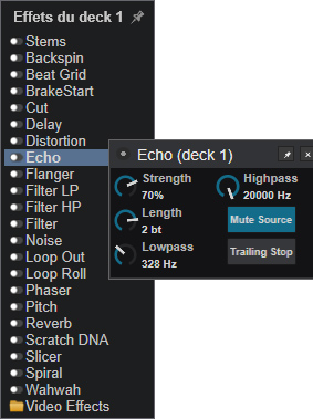

However in the effect list, i don't see the echo out. Should i assume that pressing "Mute source" has the same effect.
What is the use of "trailing stop" button ? I didn't notice any difference with or without.

![](/img/320021/15815/echo out.jpg)

that isn't echo out, you're looking a echo there, you need to install echo out.
trailing stop is related to echo fx being switched off

hi, thanks for answering. How am i supposed to install it ?
Posted Mon 31 Aug 20 @ 11:49 am
this explains extensions
https://www.virtualdj.com/manuals/virtualdj/settings/extensions.html
