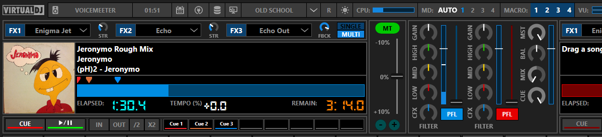

Just download Vectro skin and select "Old School" layout...
Instant training magic!!! :P

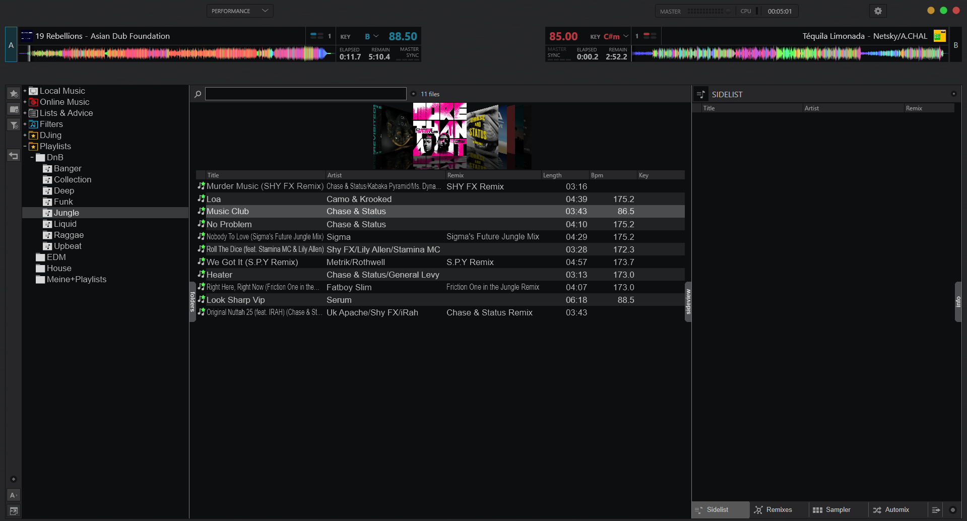

That's neat, but i'm looking for something even more minimalistic like this:
It's WIP (gotta fix the blank spaces) but already works very well for me. Browser is zoomed, i didn't remove the waveforms (i might do that)
