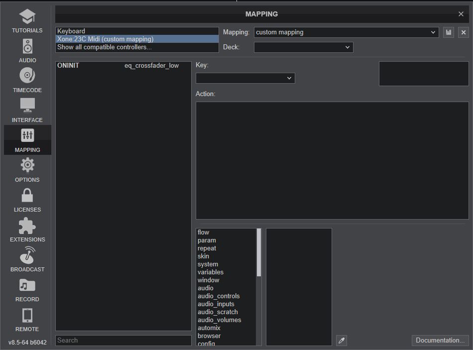

That makes sense, because the K2 is plugged into the 23C, then the 23C is connected to the computer - so the computer sees the 23C.
Do you see MIDI data in the mapping window when you press a button or move a knob/fader on the K2?
https://www.virtualdj.com/wiki/How%20do%20I%20map%20my%20MIDI%20controller.html

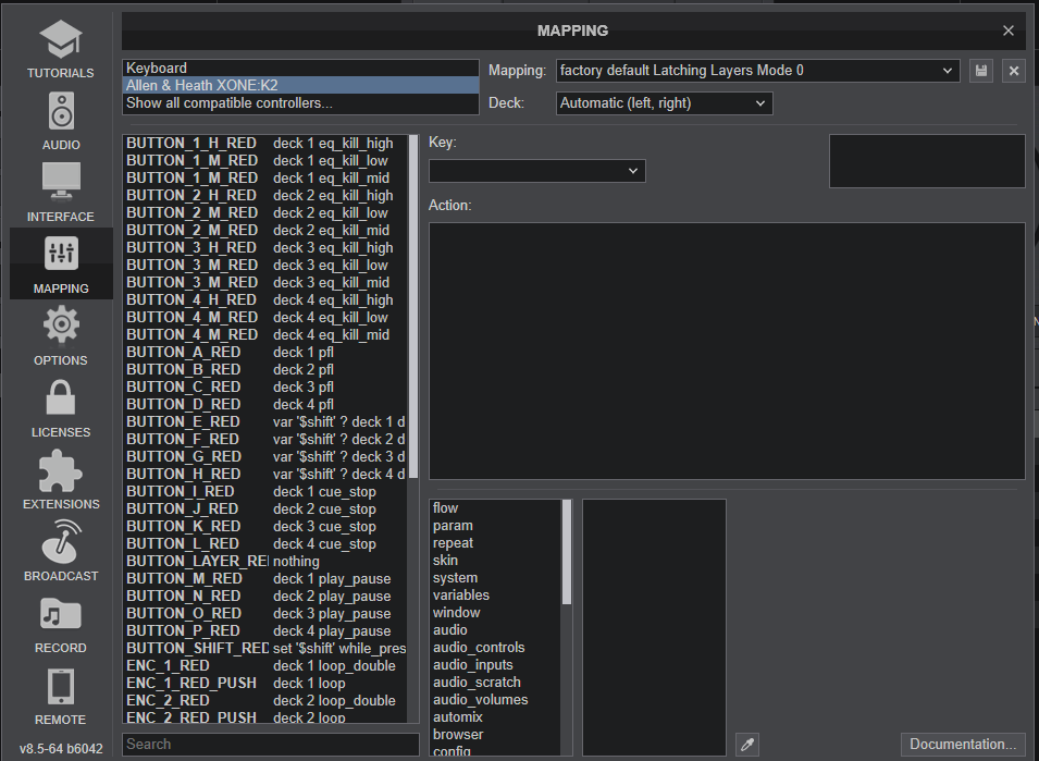

Is the K2 on the default MIDI channel (15)?
Notice the mapping says Latching Layers Mode 0 - I assume 0 means off. Check that the K2 has latching layers set to off.
Posted Fri 14 Aug 20 @ 7:18 am
Thanks for your help it was the Midi channel that was set wrong thanks for the advise.
