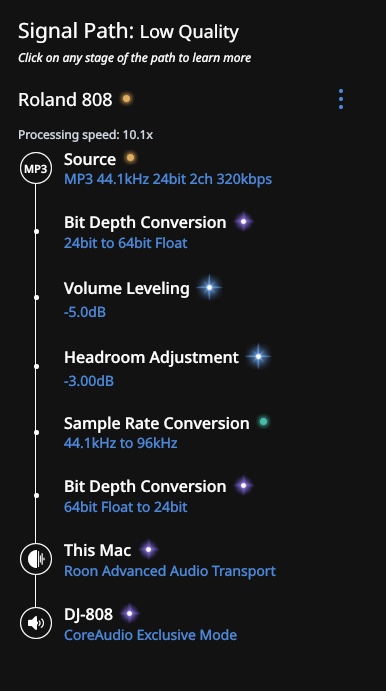

In the future I would love to use VDJ with Roon.
Roon upconverts 320 MP3's to full 24-bit audio using the higher sample rate from the devices sound card. It gives standard MP3s at 44Kbs a sonic boost higher than CD quality to whatever sample rate your sound card supports. Many DJ controllers now days come with a 24-bit/96K sound card that is usually never used to it's full potential because almost all the music out there still has the lower 44K CD quality sample rate. Hi-Res audio is starting to become popular. I would love to see VDJ being the first DJ application to support Roon integration maybe as a VST plugin?

I think you guys are misunderstanding what I said in my original post about up converting. I am not talking about bit rates, or up converting bit rates. I am talking about sample rates and how much of the song that can be read per second. Adjusting the headroom on a track isn't going to change the way the software reads the music file.
There is a noticeable difference between the same track in Roon and the same track in VDJ.
I have had 5 people listen to the difference so far. 5/5 can hear the difference and Roon wins every time. That's not to say VDJ sounds bad. I'm not saying that.
I'm saying that I can hear the same difference as I hear between CD quality Deezer tracks vs Hi-Res Masters from Tidal and I'm not the only one who can hear the difference.
Mainly, the difference being in the vocals where (especially in todays music) the vocals are not proportionate with the music. The over all sound tends to be brighter compared to something read at a higher sample rate. If VDJ can read a 44K file at a 96K sample rate, I'm not hearing it. The difference is much more pronounced in Roon.
