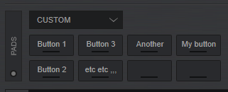

All buttons on deck are same for all decks. Play, cue, sync, pitch etc.
So it makes more sense that its for all decks the deck buttons.... Easier for users ;-)
But you can specify deck if you want, just do the action as
Thats it ;-)
Change action to what you want.
You can also use pads, unlimited amounts of custom buttons there
leftdeck ? loop : play
Thats it ;-)

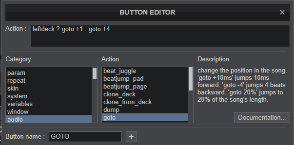

It seems that you are somehow confused with all the script patterns posted here.
Easiest way to get help is to tell us an example of a Custom skin button that you want to behave different on left/right side and we will provide you the exact script.
the only thing that cant be customized is probably the TEXT you will see on the Custom button.
Here is an example with goto function, +1 beat for Left side and +4 beats on the Right side
![](/img/318577/5866/CustomButton.png)
leftdeck ? goto +1 : goto +4
