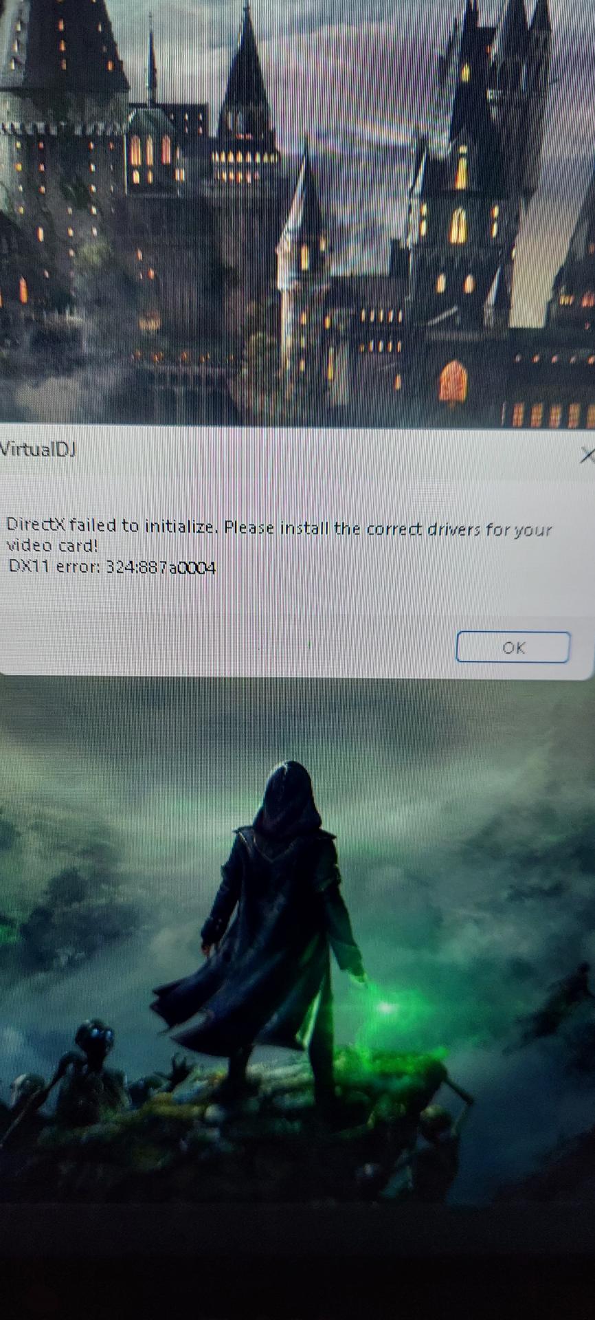

I am having this problem as well, tried all the sugguested fixes, and still occurring only when trying to open VDJ. Running wins 11pro, recently updated from wins 10pro and getting this error since update. Did an SFC scan, wins updates, upgraded drives problem recurrs.
